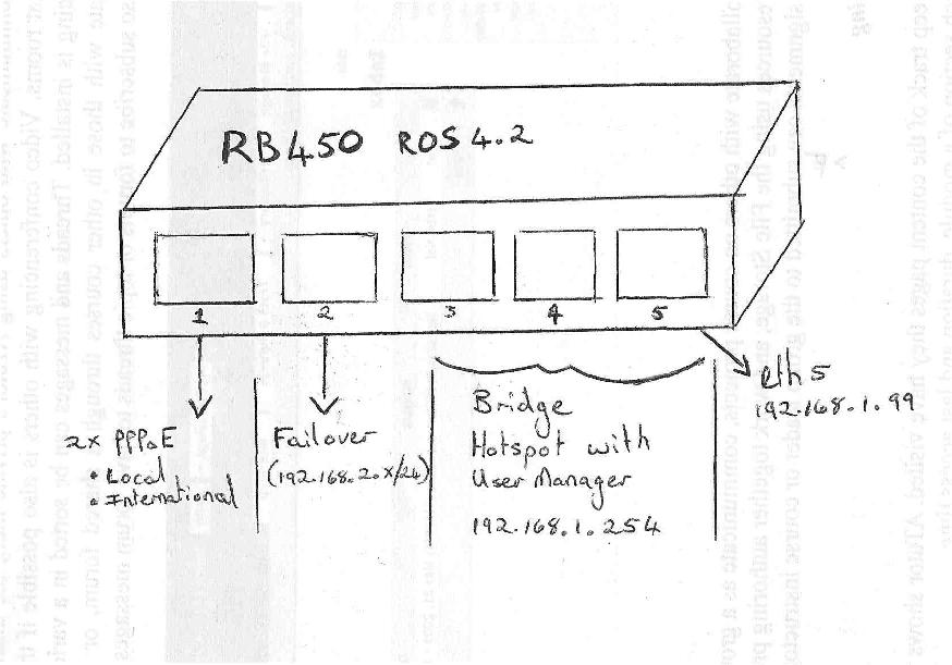

Here is my setup(refer to picture for a better idea):
RB450 running rOS4.2.
Hotspot and Userman
Splitting local and international Bandwidthe over one ADSL line using 2 PPPoE accounts and static routes.
Automatic Failover on sleeping GW over wireless link (same ISP)
Main Issue:
Everything is working perfectly up until Automatic failover part. When addd an IP address to eth2(the failover port), be it static or DHCP client, the Hotspot cannot communicate with usermanager: "Radius server is not responding". When I disble the address, everything works again and the users can log in as normal.

Sorry about the picture but I dont have visio intalled and I thought having a physical look at my setup might help the think tank. I am also planning to use netwatch to do the fail over. The RB450 has a Lv. 5 license now after 4.2 so I doubt that license would be an issue.
Let me know if there is something I forgot to print.
