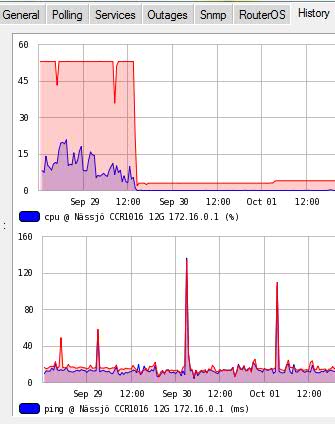

Hello Folks!
CCR1016 12G is successfully in place!
It was a big performance difference, whole network feels like new built, CPU never raised over 2%, lack of internal switch chip seems not to have any bigger influence on CPU power either.

Hello Folks!
I am very happy with CCR, the graphs speak for themself:
