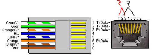

Check termination resistance between Tx and Rx lines, it is to check the definition of RJ-45,between 1 and 3,or between 2 and 6???
can someone help me :smiley: :smiley:
