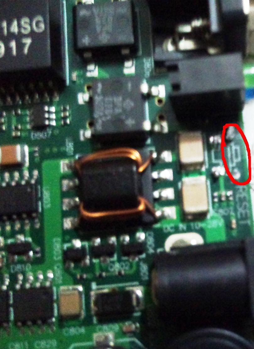

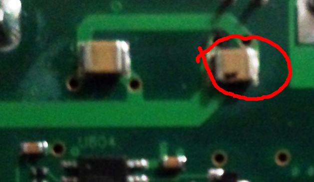

Today i show it to one electronics mechanics he found some crack behind the RB450G circuit board. I post the picture bellow.
Also i post the picture of Reset button which is broken by pressing it again and again. Bellow attached this picture too.

Maybe this can help - http://forum.mikrotik.com/t/poor-quality-of-the-capacitors-in-routerboards/49639/1
