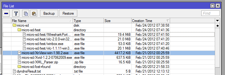

I noticed if I copy some files to the microSD card (1 GB Kingston) via SMB, after a reboot, all copied files are gone. If I do the same via FTP, after the reboot the files can be found on the card. In some cases the router cannot mount the card and the micro-sd folder is not visible in the file manager. This strage issue was not there in 5.7
I tired to update to the latest ROS 5.14 if it solves this problem, but I noticed that the copied files are cannot be found on the card after rebooting even if I copy them via FTP.
I suspect that changes are not written physically to the card before shutting down the system.

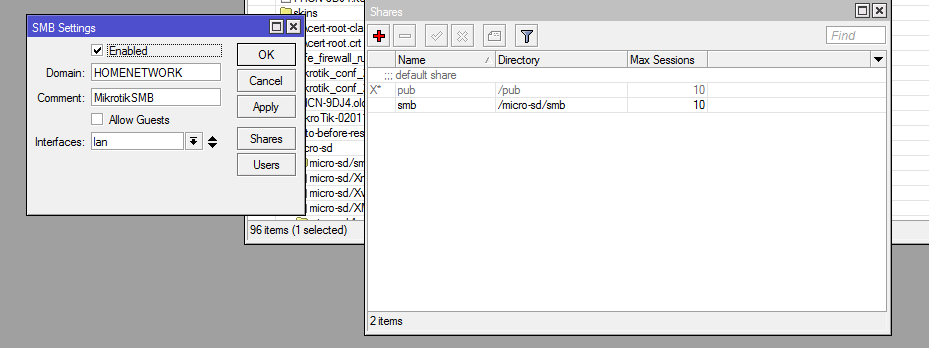

Another method for 5.13 via SMB:
  1. Create an SMB share on the microSD, for example: /micro-sd/smb
  2. Connect to this share and copy some files
  3. Reboot the router
  4. Check the files

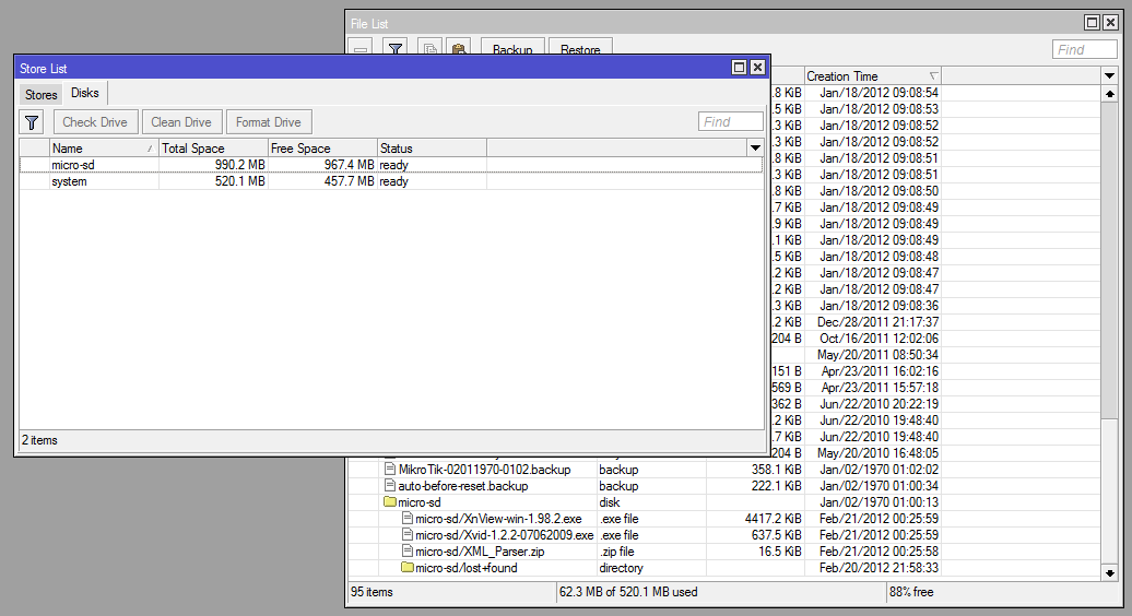

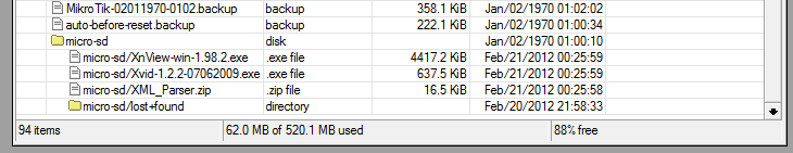

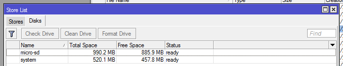

I have made some screenshots.
Another screenshots

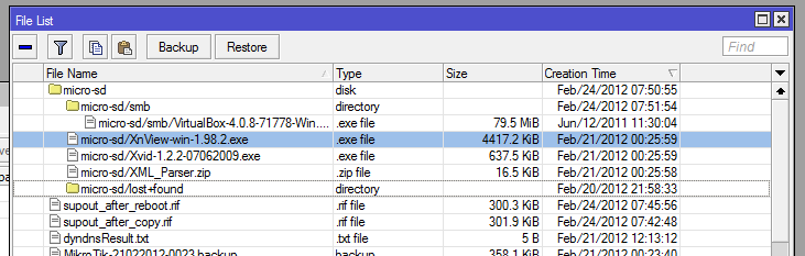

I found another symptom. If I create an SMB share in the root of the microSD and copy files to it, these files are not deleted after rebooting the router, but if I create a sub-folder it is deleted after a reboot including all its contents. So probably there is a problem with folder handling. The situation is exactly the same if I create the sub-folder via FTP. I made two supout.rif files (before and after the reboot).
