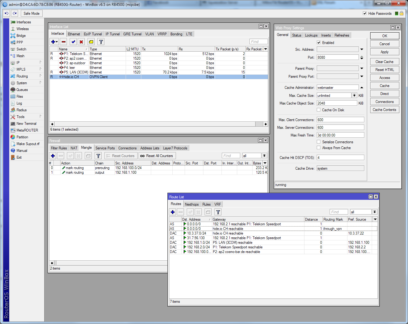

The Web Proxy is enabled and set to Port 8080. I can access it from my Machines on the local Net with 192.168.1.100:8080 and it works fine. The Machines can access the Internet.
Firewall Rules have been established. Mangle Rules were enabled.
The ‘preroute’ Mangle will push all Traffic from the WLAN Network (192.168.100.*) through the VPN Tunnel. Works fine!
Problem:
The ‘output’ Rule should force all Traffic from 192.168.1.100 (The Web Proxy) through the VPN Tunnel, but this doesn’t work. The Rule says “General” Chain output; Src. Address 192.168.1.100; “Advanced” Dst. Address is not LAN; “Action” mark_routing, Mark “through_vpn”.
The “through_vpn” Route is established and works fine for WLAN. But not for the Web Proxy. Whether I turn on or off the Proxy in my Computer’s Browser, the Connection is always established through the normal ISP Internet-Connection, not through the VPN Tunnel.

bitterbolt is a friend of mine and i helped him setup his configuration. I want to add some details to his request.
The setup he described has worked before hi updated the router to version 6.3.
We had set the source address of the web proxy to mark outgoing packets with “through_vpn” und da pakets were all routed as intended over vpn.
After the update however, the mangle roule does not work anymore even if the source address is set accordingly.
Hope i could add some details to help aus out :slight_smile:
