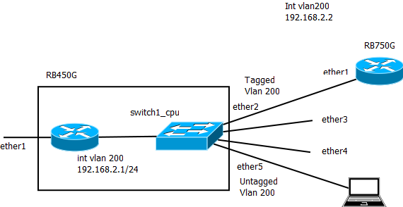

Ok, setup: 450g, vlan 200 (192.168.2.1), 1 x access interface(untagged) eth 5 connected to notebook (192.168.2.3), 1 x tagged interface eth2 connected to rb750g (192.168.2.2).
see picture.
It works, but UI for switch in Routerboard is terrible.
Config RB450G:
