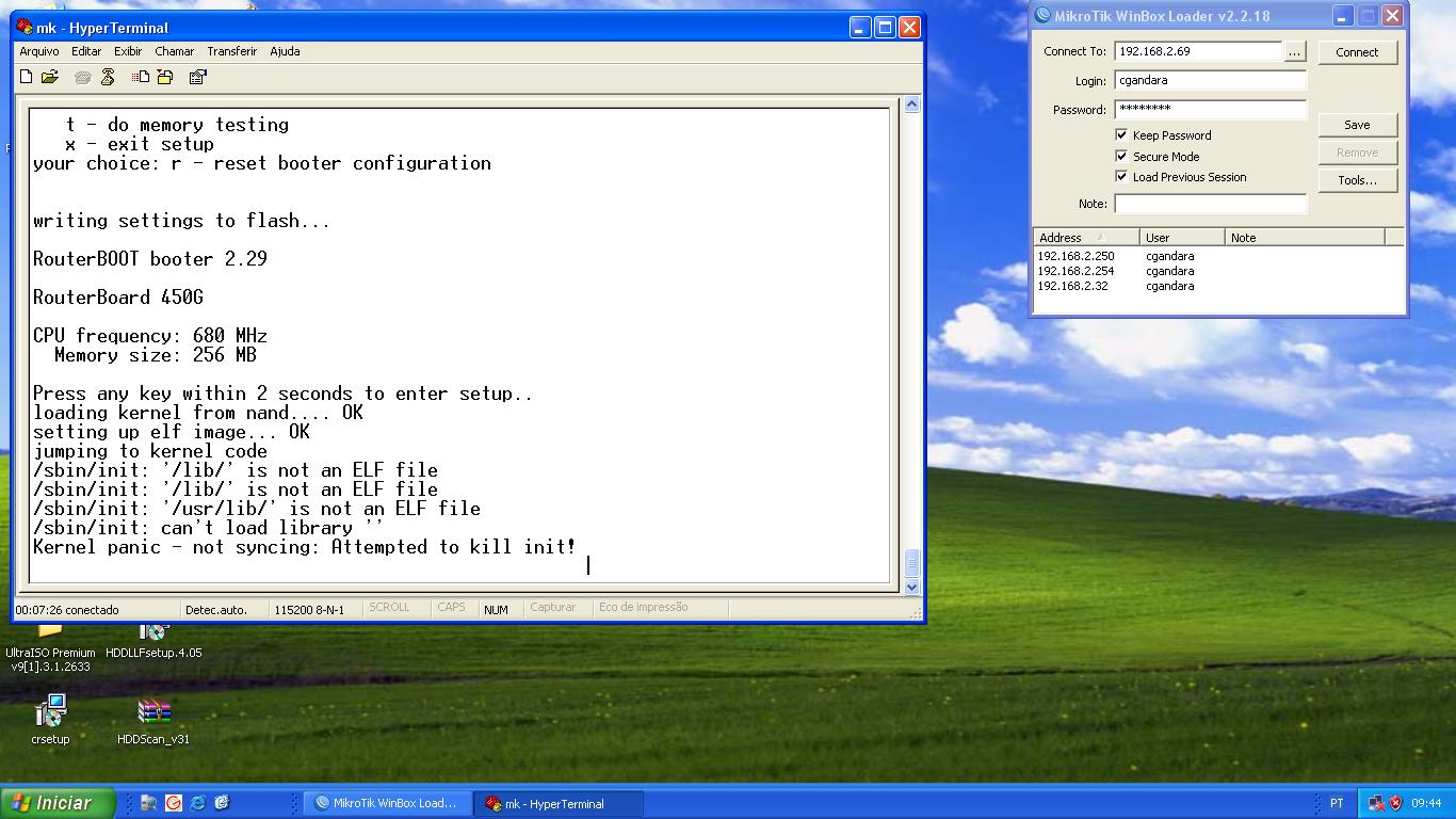

I am having a problem with this rb450g. It turns on, it beeps and that´s all. So, I tried to conect using a serial cable. It showed me this erro message, which I am gonna post here.
Any idieia how to fix it ?
Thanks.
Use Netinstall and install RouterOS v5.5,

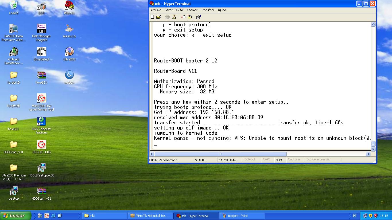

Now I am this problem with a rb411. I´ve tried the same approach but it stopped in this erro mesage.
Use the latest netinstall v5.6 and RouterOS v5.6 to recover RB411.
I´ve tried with v 5.5. But the problem is, I can´t get pass that. I choose " O " , theun " E ", and there it shows this erro message.
Try v5.6.
Attach screenshot with error.
I did it already. It is the 2nd picturein the post.
I have doubts about v2.12 for RouterBOOT.
Use third method to upgrade RouterBOOT version to newer version,
http://wiki.mikrotik.com/wiki/Manual:Bootloader_upgrade

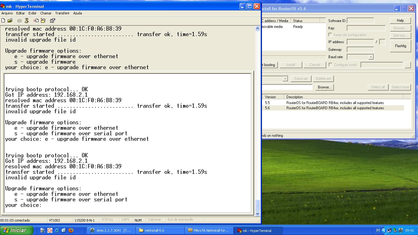

your choice: g - upgrade firmware
Upgrade firmware options:
e - upgrade firmware over ethernet
s - upgrade firmware over serial port
your choice: s - upgrade firmware over serial port
xmodem receiver ready, waiting for data...
press <Ctrl>+X several times to cancel transfer

Buddy,
that´s what I get and I try.
You need to select s - upgrade firmware over serial port
I did select it, and It seems go nowhere. It tells to press control+x to cancel.
