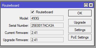

It’s only the RB493Gs that crash. The bootloader is 4.21 on those. It’s 4.21 on 5.20 remains 4.21 after upgrading to 5.22

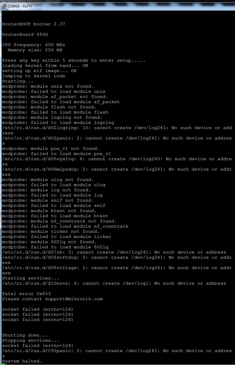

I have also problem with instaling 5.22. Console output - see image. Before with ROS 5.11 running perfectly
I recommend running Netinstall to format and reinstll the OS.
OK, I’ve done that on these two. It’s not always easy to get to these sites.
