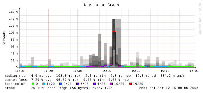

the problems are not by much wlan load (max 500kbits up and down ) - i think if many connections and filesharing (p2p) is running by the clients the wlan traffic will be crashed ( see picture smokeping 7 retiers)

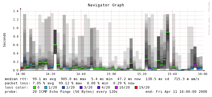

the 2nd picture you see is with 15 hardware retiers - !! all clients have this connection like the picture …

It’s not an issue of this or that CPE you’re using but CSMA protocol. With p2p you’re getting a lot of packet per second traffic and with 30 users you get a lot of collisions therefore you’re just starting to experience beauty of 802.11b/g CSMA protocol.
See this for explanation: http://aqua.comptek.ru/test/HiddenNode/hidden_node_en.html
You need to either split your users per more than one access point or use some kind of polling protocol (I believe both osbridge and mikrotik offer these as a proprietary extension to 802.11b/g).
