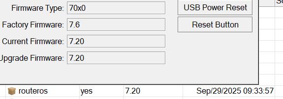

And what RouterOS and firmware version are you currently running?
SFP+ port is beeing used as downlink to my CRS310-8G+2S+IN switch via 10G fiber.
Running latest 7.20.

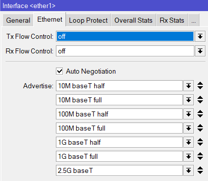

It shows like this on my device, maybe you need to add the line with 2.5G ?
And ... make sure you use CAT6a cable at least. Not CAT5E.
Thats the interface on the Mikrotik. The problem with 7.20 currently is that the link partners advertised 2.5G is not shown/correctly recognized when you have a link. For testing purposes i ordered new CAT8.1 cables already.
