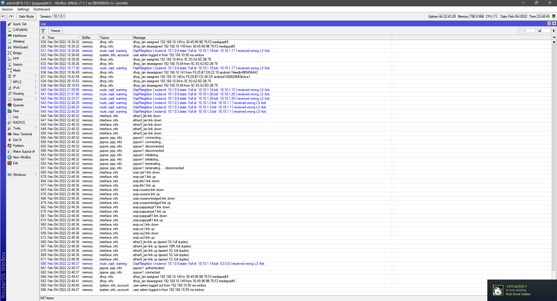

RB5009 : all connected ports flap a few times a day
All the connected ports on my RB5009 running 7.1.1 are flapping a few times a day. They all go down together and come back up after 5 seconds. All the ports are connected to different devices and there is nothing in the logs indicating what could be happening :
 21:47:46 interface,info ether1 link down
 21:47:46 interface,info ether2-trunk link down
 21:47:46 interface,info ether3-trunk link down
 21:47:46 interface,info ether4-trunk link down
 21:47:51 interface,info ether1 link up (speed 1G, full duplex)
 21:47:51 interface,info ether2-trunk link up (speed 1G, full duplex)
 21:47:51 interface,info ether3-trunk link up (speed 1G, full duplex)
 21:47:51 interface,info ether4-trunk link up (speed 1G, full duplex)
Is anyone experiencing the same ?

I think I might be getting closer …
Other several days with no Winbox connected = no flaps.
A few days with Winbox connected, but showing only the interface table = no flaps and graphs look ok.
As soon as I add DHCP server / lease table = gaps started to appear on graphs immediately and all ports flapped after around 2.5 hours.
You’re right. Having the DHCP server → Lease table showing, is causing it. This makes sense as I have DHCP server running on both my RB5009’s and often have the leases window open. Lately I haven’t been working on any network config and surprisingly everything has been stable for nearly 2 weeks (with or without winbox running). I’m reluctant to get my hopes up over here BUT you may have just found the problem !!!
Here’s a screen capture of me reproducing the issue: https://youtu.be/A7CE2Q67pg8
I will leave the Leases window open and see if I get another flap of connected ports (it’s been several days now without)
This. I can reproduce this on a RB5009 running 7.1.1: Having Winbox connected and leave the the DHCP lease Window open, all ports flapped after about 50 minutes. I mostly use the CLI and never had all-port-flaps in the logs before.
Looking at the port LEDs while it happens and regarding the fact all ports flap together, it seems like the switch chip is getting reseted somehow.
The occasional single-port flaps reported by some userers are most likely problems of specific link-pair combinations and not directly related. This is more something like the single port flap issues of the past on RB3011 and SFP of RB4011.
The interesting question is why MT devices in general tends to have flap issues. Except in one case were a port on a Zyxel AP was defective, alle the flaps we experienced had a MT port in the link and were the fault of the MT device fixed with later updates. And we use a lot of gear of different brands.
I can reproduce it on my end as well. Curiously though if I run a ping to an external website from my laptop and then monitor the ping times while the ports are flapping, I don’t see a change in response time. You’d think I would be losing packets or, at the very least, experiencing an increase in latency no? Perhaps this is a cosmetic issue or have you all actually seen performance hits as a result?
I also notice that when the flap occurs, my CPU use goes from 1% up to 9% or so. I ran tools/profile and “management” is the process that seems to be gobbling the extra cycles. “Unclassified” also seems to jump a little. No idea what what that actually means but it correlates precisely with every flapping event. Once I move off of the leases tab, the flapping stops and I stop experiencing the sudden spikes in CPU use.
EDIT: Using ROS 7.2rc3
I am definitely getting a few seconds outage.
OK, My ports just flapped again for the first time in several days because of this discovery. I enabled DHCP lease window at around 21:20 my time. And now around 22:45 I just had ports flap issue.
Seems pretty definitive now !! Nice work @mainTAP :+1:t2:
v7.1.1 RB5009 Link SFP+ <—> any device with SFP (SFP+) packet loss 35-50%, regardless of the load. Tested on two RB5009.
v6.49.2 CRS328 Link SFP+ <—> any device with SFP (SFP+) packet loss 0%, regardless of the load.
Everyone has this problem with packet loss on the port SFP+?
Hi all.
Just advising that this problem is also triggered whenever viewing the “IP → ARP List” Window ..
Also, this is not a Winbox problem, as the issue occurs even if you access these menus from Webfig.
