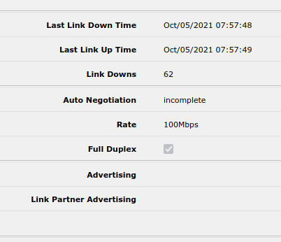

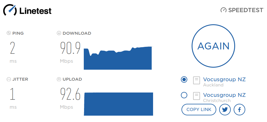

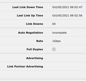

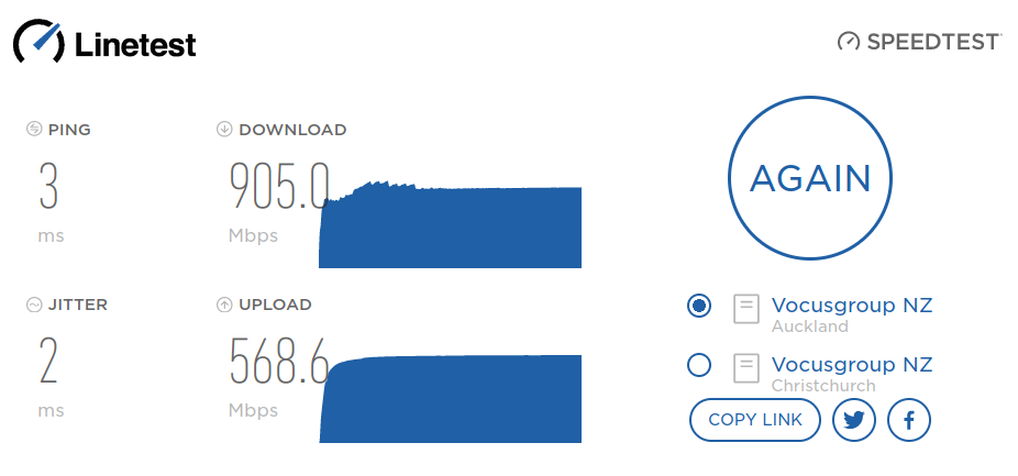

Hmm, so I connected SFP to cheap dlink gig switch then other switch port to ONT and SFP was running at 1Gps for 30min or so with no issues
This is SFP directly to ONT:

This is SFP connected through switch to ONT:

Link auto neg is still incomplete though
