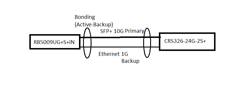

My plan is to connect both device with Bonding interface (Active Backup) SFP+ as primary, and ether7 as backup. The idea is to achieve HA if any how the SFP+ link gets disconnected.

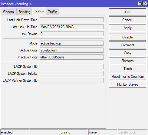

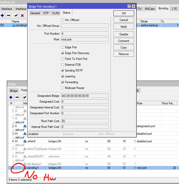

When I did that, the bonding works. However, the bonding interface in my bridge ports status is not hardware offloaded.
I’ve tested it, and CPU % goes up every time there is any L2 traffic from Router to Switch.
My expectation is Bonding interface should be hardware offloaded, especially in normal condition (Primary interface SFP+ is online). Because in normal condition, it just like my current condition without bonding interface set up, no fancy balancing algorithm is being processes, and traffic is flowing to only single port (SFP+). Also, according to my router block diagram, SFP+ port is connected to the same switch with Ethernet port, so I assume the interface is still connected to the same chip/hardware and hardware offload is possible, right?

My question, why bonding interface on my RB5009 not hardware offloaded? Is it because hardware offload in bonding interface using different type of interface is not supported, or something else?
I have attached some image to better explain my situation.

This document mentions that only 802.3ad bonding and balance-xor are offloaded to hardware. CRS326 is in the device class explicitly mentioned, I would expect RB5009 to fall in this category as well as it has a pretty advanced switch chip. Bond type active-backup is not HW offloaded on any of devices AFAIK.
