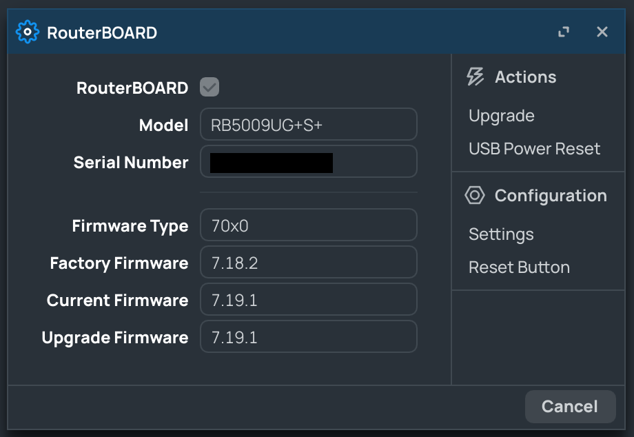

First I tried the bb-upgrade-7.6.dpk file and that installed the 7.6 backup bootloader (aka “Factory Firmware”) just fine. I was intrigued.
Then I extracted the backup bootloader for the 70x0 target from the bb-upgrade-7.18.2.dpk file and hand-patched it into a flash dump of my router.
The 7.18.2 backup bootloader itself works. Looks like the installation process has a bug that caused erasing of the flash without writing a new backup bootloader.
The 7.18.2 backup bootloader is a few bytes smaller than the 7.6. one. Maybe that’s what tripped up the installer.
Netinstalled 7.19.1 from the 7.18.2 backup loader successfully.
Either way. I’m all up to date now :laughing:
