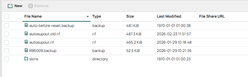

Hi my new, 1 month old, RB5009 just crashed. Did not want to allow any physical connections on any of the inputs, only ether1 was responding the others did not blink “orange” (poe) or green when connected through cable.
I tried all ports with, different cables, all of them showed a green light on eth1 but on no other ports.
I ended up with a reset of the RB5009 and then I restored using my stored config.

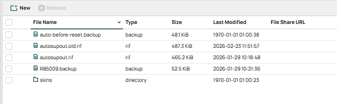

Now to my question, how can I find out what the reason for the crash was? I have the following files on it:
RB5009.backup is the one I uploaded after the reset, the others were on the router after the rest.
You can open a case with Mikrotik and provide them the “autosupout.rif” file. That is generated when stuff usually goes wrong.
Not 100% sure it can identity what caused the sudden crash but you can try.

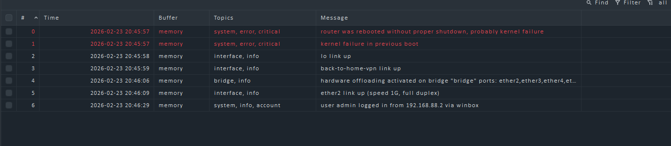

Well it crashed today again, this time I was at home and managed to reboot back to life. Same issue suddenly the wired ports stopped working, POE still active but no green light indicating traffic.
After a reboot I got this in my logs:
