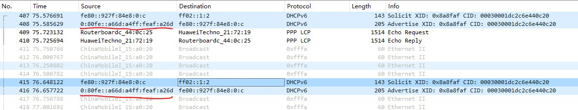

I found the reason now.
The BRAS(DHCPv6 Server) send Advertisement with a wrong Link-local Address as below
407 75.576691 fe80::927f:84e8:0:c ff02::1:2 DHCPv6 143 Solicit XID: 0x8a8faf CID: 00030001dc2c6e440c20
408 75.585629 > 0:80fe::a66d:a4ff:feaf:a26d > fe80::927f:84e8:0:c DHCPv6 205 Advertise XID: 0x8a8faf CID: 00030001dc2c6e440c20
As the address is not in the range of FE80::/10, the RouterOS IPv6 firewall dropped the Advertisement packets.

I think that mean the ISP uses DHCPv6 Relay or something like that internally. Probably a similar case to what customers of Xfinity/Comcast report.
http://forum.mikrotik.com/t/xfinity-comcast-dhcpv6-configuration-change/156031/1
That, in essence, means that the DHCPv6 Server address is not link-local and thus cannot be used as the default gateway.
I usually recommend to people to configure the DHCPv6 Client to add a default route (add-default-route=yes), but with a higher administrative distance (that equals to lower priority, like default-route-distance=3) than the default route obtained via Router Advertisement, which means it can still serve as a fallback in case the ISP messes up the timers in the Router Advertisements, for example. But in your case, since the DHCPv6 Server is not located in the same link-local space, you’re better off not adding the default route (add-default-route=no).
Thanks for your comment, it helps me a lot. The post you referenced list a case nearly the same as me. I’m not sure whether My ISP changed for DHCPv6 relay, but the IPv6 firewall Tuning ideas in the post looks great.:+1:
Setting a DHCPv6 client add-default-route=yes is just wrong as the DHCPv6 protocol has no concept of a default route. Faking one from the source address of the DHCPv6 replies often works, but can easily fail if the ISP has different devices providing the DHCPv6 service and the gateway.
The Mikrotik default firewall rules are also incorrect, whilst link-local addresses are the most common for DHCPv6 messages GUA and ULA are also valid. Instead of:
add chain=input action=accept protocol=udp dst-port=546 src-address=fe80::/10 comment=“defconf: accept DHCPv6-Client prefix delegation.”
accepting DHCPv6 replies would be better:
add chain=input action=accept protocol=udp dst-port=546 src-port=547 comment=“accept DHCPv6 server-to-client replies”
