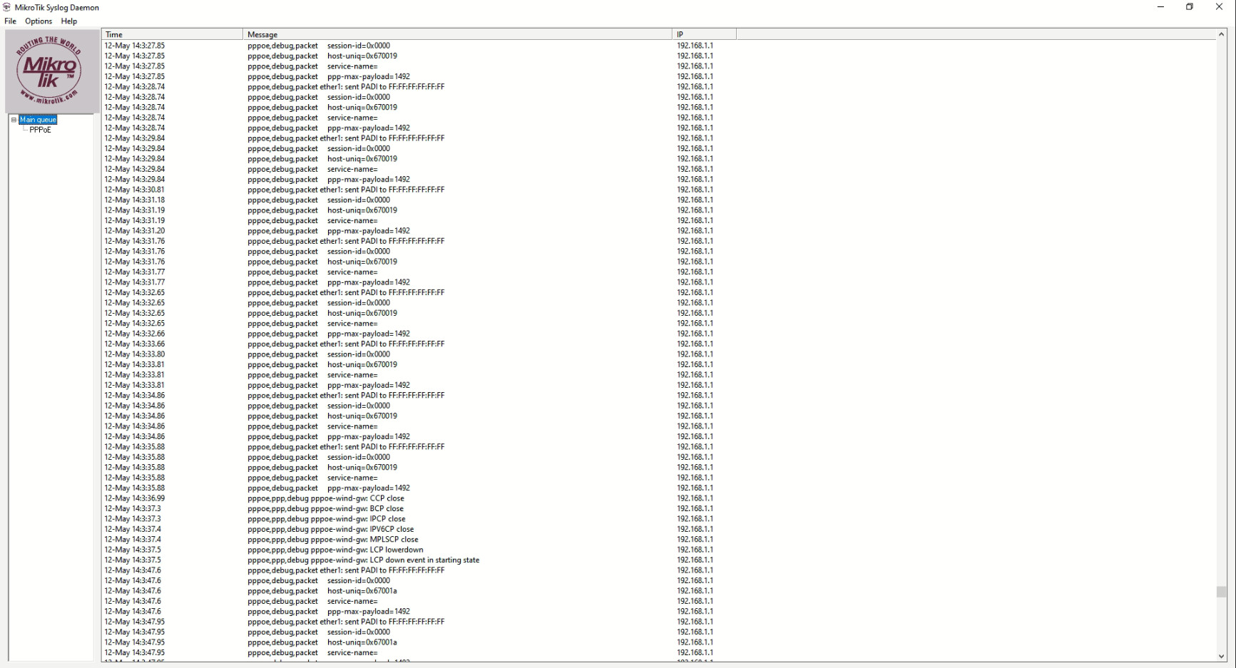

I am experiencing the same thing as @ornithophobe. Previously i had an edgerouter x which made a second pppoe dial behind isp’s modem/router (pppoe passthrough). Maybe once in two months i had a disconnect and ip changed. Now with rb5009 i notice that every night i have 1 disconnect. I will check the logs and post it here in case there is a termination request from isp or something else. The strange thing is that with edgeeouter x i didnt have disconnecta so often..

Thank’s for replying. I have internet traffic all the time so i suppose that the problem is something else. Here is the log from mikrotik when it disconnects pppoe.
Sorry for uploading log as an image but i keep the logs in mikrotik syslog daemon and tried to export but it didn’t show the whole messages.
Ok, let me rephrase, from my understanding of PPPoE:
LCP Echo Requests and LCP Echo Replies only show up when there’s no traffic through the PPPoE tunnel, and they are intended to keep the tunnel alive.
So seeing them in the logs indicates that at that time there was no traffic flowing, as your logs point out I see it as this:
something stopped the traffic, lcp echo requests and replies started flowing, then the pppoe server stopped answering to those too.
And your client didn’t manage to reconnect to any pppoe server after that because it (the server) was probably down already.
The logs after what you’ve posted should have a record of the PPPoE server coming back up.
So, I’m blaming the ISP or some equipment in between.
I’m also using RB5009 with PPPoE and I’ve encountered no issues. But my ISP doesn’t require any vlans or something else special.
It seems that the problem is from my ISP because 2/3 when mikrotik disconnects my ISP’s router loses vdsl sync.These LCP echo requests are made from ISP’s side every 30 seconds even if there is internet traffic. I am waiting for their technician to come over in order to check the line. Here are the logs when my main modem/router loses vdsl sync.

pppoe,ppp,debug pppoe-wind-gw: IPCP close in 11-May 23:6:30.83 from 192.168.1.1
pppoe,ppp,debug pppoe-wind-gw: IPV6CP close in 11-May 23:6:30.84 from 192.168.1.1
pppoe,ppp,debug pppoe-wind-gw: MPLSCP close in 11-May 23:6:30.84 from 192.168.1.1
pppoe,ppp,debug pppoe-wind-gw: LCP lowerdown in 11-May 23:6:30.85 from 192.168.1.1
pppoe,ppp,debug pppoe-wind-gw: LCP down event in starting state in 11-May 23:6:30.85 from 192.168.1.1
pppoe,ppp,debug pppoe-wind-gw: CCP close in 11-May 23:6:30.85 from 192.168.1.1
pppoe,ppp,debug pppoe-wind-gw: BCP close in 11-May 23:6:30.86 from 192.168.1.1
pppoe,ppp,debug pppoe-wind-gw: IPCP close in 11-May 23:6:30.87 from 192.168.1.1
pppoe,ppp,debug pppoe-wind-gw: IPV6CP close in 11-May 23:6:30.87 from 192.168.1.1
pppoe,ppp,debug pppoe-wind-gw: MPLSCP close in 11-May 23:6:30.88 from 192.168.1.1
pppoe,ppp,debug pppoe-wind-gw: LCP lowerdown in 11-May 23:6:30.88 from 192.168.1.1
pppoe,ppp,debug pppoe-wind-gw: LCP down event in starting state in 11-May 23:6:30.88 from 192.168.1.1
pppoe,ppp,debug pppoe-wind-gw: CCP close in 11-May 23:6:30.89 from 192.168.1.1
pppoe,ppp,debug pppoe-wind-gw: BCP close in 11-May 23:6:30.89 from 192.168.1.1
pppoe,ppp,debug pppoe-wind-gw: IPCP close in 11-May 23:6:30.89 from 192.168.1.1
pppoe,ppp,debug pppoe-wind-gw: IPV6CP close in 11-May 23:6:30.89 from 192.168.1.1
pppoe,ppp,debug pppoe-wind-gw: MPLSCP close in 11-May 23:6:30.89 from 192.168.1.1
pppoe,ppp,debug pppoe-wind-gw: LCP lowerdown in 11-May 23:6:30.89 from 192.168.1.1
pppoe,ppp,debug pppoe-wind-gw: LCP down event in starting state in 11-May 23:6:30.89 from 192.168.1.1
pppoe,debug,packet ether1: sent PADI to FF:FF:FF:FF:FF:FF in 11-May 23:6:37.88 from 192.168.1.1
pppoe,debug,packet     session-id=0x0000 in 11-May 23:6:37.88 from 192.168.1.1
pppoe,debug,packet     host-uniq=0x670013 in 11-May 23:6:37.88 from 192.168.1.1
pppoe,debug,packet     service-name= in 11-May 23:6:37.88 from 192.168.1.1
pppoe,debug,packet     ppp-max-payload=1492 in 11-May 23:6:37.88 from 192.168.1.1
pppoe,debug,packet ether1: sent PADI to FF:FF:FF:FF:FF:FF in 11-May 23:6:38.89 from 192.168.1.1
pppoe,debug,packet     session-id=0x0000 in 11-May 23:6:38.89 from 192.168.1.1
pppoe,debug,packet     host-uniq=0x670013 in 11-May 23:6:38.89 from 192.168.1.1
pppoe,debug,packet     service-name= in 11-May 23:6:38.89 from 192.168.1.1
pppoe,debug,packet     ppp-max-payload=1492 in 11-May 23:6:38.89 from 192.168.1.1
pppoe,debug,packet ether1: sent PADI to FF:FF:FF:FF:FF:FF in 11-May 23:6:39.81 from 192.168.1.1
pppoe,debug,packet     session-id=0x0000 in 11-May 23:6:39.81 from 192.168.1.1
pppoe,debug,packet     host-uniq=0x670013 in 11-May 23:6:39.81 from 192.168.1.1
pppoe,debug,packet     service-name= in 11-May 23:6:39.81 from 192.168.1.1
pppoe,debug,packet     ppp-max-payload=1492 in 11-May 23:6:39.81 from 192.168.1.1
pppoe,ppp,debug pppoe-wind-gw: CCP close in 11-May 23:6:40.81 from 192.168.1.1
pppoe,ppp,debug pppoe-wind-gw: BCP close in 11-May 23:6:40.81 from 192.168.1.1
pppoe,ppp,debug pppoe-wind-gw: IPCP close in 11-May 23:6:40.81 from 192.168.1.1
pppoe,ppp,debug pppoe-wind-gw: IPV6CP close in 11-May 23:6:40.81 from 192.168.1.1
pppoe,ppp,debug pppoe-wind-gw: MPLSCP close in 11-May 23:6:40.81 from 192.168.1.1
pppoe,ppp,debug pppoe-wind-gw: LCP lowerdown in 11-May 23:6:40.81 from 192.168.1.1
pppoe,ppp,debug pppoe-wind-gw: LCP down event in starting state in 11-May 23:6:40.81 from 192.168.1.1
pppoe,debug,packet ether1: sent PADI to FF:FF:FF:FF:FF:FF in 11-May 23:6:40.88 from 192.168.1.1
pppoe,debug,packet     session-id=0x0000 in 11-May 23:6:40.88 from 192.168.1.1
pppoe,debug,packet     host-uniq=0x670014 in 11-May 23:6:40.88 from 192.168.1.1
pppoe,debug,packet     service-name= in 11-May 23:6:40.88 from 192.168.1.1
pppoe,debug,packet     ppp-max-payload=1492 in 11-May 23:6:40.88 from 192.168.1.1
pppoe,debug,packet ether1: sent PADI to FF:FF:FF:FF:FF:FF in 11-May 23:6:41.78 from 192.168.1.1
pppoe,debug,packet     session-id=0x0000 in 11-May 23:6:41.78 from 192.168.1.1
pppoe,debug,packet     host-uniq=0x670014 in 11-May 23:6:41.78 from 192.168.1.1
pppoe,debug,packet     service-name= in 11-May 23:6:41.78 from 192.168.1.1
pppoe,debug,packet     ppp-max-payload=1492 in 11-May 23:6:41.78 from 192.168.1.1
pppoe,debug,packet ether1: sent PADI to FF:FF:FF:FF:FF:FF in 11-May 23:6:42.89 from 192.168.1.1
pppoe,debug,packet     session-id=0x0000 in 11-May 23:6:42.89 from 192.168.1.1
pppoe,debug,packet     host-uniq=0x670014 in 11-May 23:6:42.89 from 192.168.1.1
pppoe,debug,packet     service-name= in 11-May 23:6:42.89 from 192.168.1.1
pppoe,debug,packet     ppp-max-payload=1492 in 11-May 23:6:42.89 from 192.168.1.1
pppoe,debug,packet ether1: sent PADI to FF:FF:FF:FF:FF:FF in 11-May 23:6:43.96 from 192.168.1.1
pppoe,debug,packet     session-id=0x0000 in 11-May 23:6:43.96 from 192.168.1.1
pppoe,debug,packet     host-uniq=0x670014 in 11-May 23:6:43.96 from 192.168.1.1
pppoe,debug,packet     service-name= in 11-May 23:6:43.96 from 192.168.1.1
pppoe,debug,packet     ppp-max-payload=1492 in 11-May 23:6:43.96 from 192.168.1.1
pppoe,debug,packet ether1: sent PADI to FF:FF:FF:FF:FF:FF in 11-May 23:6:44.87 from 192.168.1.1

pppoe,debug,packet     host-uniq=0x670023 in 11-May 23:10:5.13 from 192.168.1.1
pppoe,debug,packet     service-name= in 11-May 23:10:5.13 from 192.168.1.1
pppoe,debug,packet     ppp-max-payload=1492 in 11-May 23:10:5.13 from 192.168.1.1
pppoe,debug,packet     ac-name=AthMet1BNG01 in 11-May 23:10:5.13 from 192.168.1.1
pppoe,debug ether1: received PADO with unknown host-uniq, dropping in 11-May 23:10:5.13 from 192.168.1.1
pppoe,debug,packet ether1: rcvd PADO from 6C:6C:D3:2C:F0:D2 in 11-May 23:10:5.13 from 192.168.1.1
pppoe,debug,packet     session-id=0x0000 in 11-May 23:10:5.13 from 192.168.1.1
pppoe,debug,packet ether1: rcvd PADO from 6C:6C:D3:2C:F0:C6 in 11-May 23:10:5.13 from 192.168.1.1
pppoe,debug,packet ether1: rcvd PADO from 6C:6C:D3:2C:F0:CF in 11-May 23:10:5.13 from 192.168.1.1
pppoe,debug,packet ether1: rcvd PADO from 6C:6C:D3:2C:F0:C9 in 11-May 23:10:5.13 from 192.168.1.1
pppoe,debug,packet     service-name= in 11-May 23:10:5.14 from 192.168.1.1
pppoe,debug,packet     ppp-max-payload=1492 in 11-May 23:10:5.14 from 192.168.1.1
pppoe,debug,packet     ac-name=AthMet1BNG01 in 11-May 23:10:5.14 from 192.168.1.1
pppoe,debug ether1: received PADO with unknown host-uniq, dropping in 11-May 23:10:5.14 from 192.168.1.1
pppoe,debug,packet ether1: rcvd PADO from 6C:6C:D3:2C:F0:D1 in 11-May 23:10:5.14 from 192.168.1.1
pppoe,debug,packet     session-id=0x0000 in 11-May 23:10:5.14 from 192.168.1.1
pppoe,debug,packet     host-uniq=0x670023 in 11-May 23:10:5.14 from 192.168.1.1
pppoe,debug,packet ether1: rcvd PADO from 6C:6C:D3:2C:F1:87 in 11-May 23:10:5.14 from 192.168.1.1
pppoe,debug,packet     ac-name=PhiMSC1BNG01 in 11-May 23:10:5.14 from 192.168.1.1
pppoe,debug,packet ether1: rcvd PADO from 6C:6C:D3:2C:F1:91 in 11-May 23:10:5.14 from 192.168.1.1
pppoe,debug,packet ether1: rcvd PADO from 6C:6C:D3:2C:F1:90 in 11-May 23:10:5.14 from 192.168.1.1
pppoe,debug,packet     session-id=0x0000 in 11-May 23:10:5.15 from 192.168.1.1
pppoe,debug,packet     host-uniq=0x670023 in 11-May 23:10:5.15 from 192.168.1.1
pppoe,debug,packet     service-name= in 11-May 23:10:5.15 from 192.168.1.1
pppoe,debug,packet     ppp-max-payload=1492 in 11-May 23:10:5.15 from 192.168.1.1
pppoe,debug,packet     ac-name=PhiMSC1BNG01 in 11-May 23:10:5.15 from 192.168.1.1
pppoe,debug ether1: received PADO with unknown host-uniq, dropping in 11-May 23:10:5.15 from 192.168.1.1
pppoe,debug,packet ether1: rcvd PADO from F4:DB:E6:CB:92:50 in 11-May 23:10:5.15 from 192.168.1.1
pppoe,debug,packet ether1: rcvd PADO from B0:26:80:4B:5C:85 in 11-May 23:10:5.16 from 192.168.1.1
pppoe,debug,packet     session-id=0x0000 in 11-May 23:10:5.16 from 192.168.1.1
pppoe,debug,packet     host-uniq=0x670023 in 11-May 23:10:5.16 from 192.168.1.1
pppoe,debug,packet     service-name= in 11-May 23:10:5.16 from 192.168.1.1
pppoe,debug,packet     ppp-max-payload=1492 in 11-May 23:10:5.16 from 192.168.1.1
pppoe,debug,packet     ac-name=AthMet1BNG01 in 11-May 23:10:5.16 from 192.168.1.1
pppoe,debug ether1: received PADO with unknown host-uniq, dropping in 11-May 23:10:5.16 from 192.168.1.1
pppoe,debug,packet ether1: rcvd PADO from B0:26:80:4B:5C:90 in 11-May 23:10:5.16 from 192.168.1.1
pppoe,debug,packet ether1: rcvd PADO from B0:26:80:4B:5C:86 in 11-May 23:10:5.16 from 192.168.1.1
pppoe,debug,packet ether1: rcvd PADO from B0:26:80:4B:5C:8F in 11-May 23:10:5.16 from 192.168.1.1
pppoe,debug,packet     service-name= in 11-May 23:10:5.17 from 192.168.1.1
pppoe,debug,packet     ppp-max-payload=1492 in 11-May 23:10:5.17 from 192.168.1.1
pppoe,debug,packet     ac-name=AthMet1BNG01 in 11-May 23:10:5.17 from 192.168.1.1
pppoe,debug ether1: received PADO with unknown host-uniq, dropping in 11-May 23:10:5.17 from 192.168.1.1
pppoe,debug,packet ether1: rcvd PADO from B0:26:80:4B:5C:88 in 11-May 23:10:5.17 from 192.168.1.1
pppoe,debug,packet     session-id=0x0000 in 11-May 23:10:5.17 from 192.168.1.1
pppoe,debug,packet     host-uniq=0x670023 in 11-May 23:10:5.17 from 192.168.1.1
pppoe,debug,packet ether1: rcvd PADO from B0:26:80:4B:5C:92 in 11-May 23:10:5.17 from 192.168.1.1
pppoe,debug,packet ether1: rcvd PADO from B0:26:80:4B:5C:89 in 11-May 23:10:5.17 from 192.168.1.1
pppoe,ppp,debug,packet  pppoe-wind-gw: rcvd LCP EchoReq id=0x1 in 11-May 23:10:19.73 from 192.168.1.1
pppoe,ppp,debug,packet     <magic 0xb5f77c4f> in 11-May 23:10:19.74 from 192.168.1.1
pppoe,ppp,debug,packet  pppoe-wind-gw: sent LCP EchoRep id=0x1 in 11-May 23:10:19.74 from 192.168.1.1
pppoe,ppp,debug,packet     <magic 0x774d8129> in 11-May 23:10:19.74 from 192.168.1.1
pppoe,ppp,debug,packet  pppoe-wind-gw: rcvd LCP EchoReq id=0x2 in 11-May 23:10:49.54 from 192.168.1.1
pppoe,ppp,debug,packet     <magic 0xb5f77c4f> in 11-May 23:10:49.54 from 192.168.1.1
pppoe,ppp,debug,packet  pppoe-wind-gw: sent LCP EchoRep id=0x2 in 11-May 23:10:49.54 from 192.168.1.1
pppoe,ppp,debug,packet     <magic 0x774d8129> in 11-May 23:10:49.54 from 192.168.1.1
pppoe,ppp,debug,packet  pppoe-wind-gw: rcvd LCP EchoReq id=0x3 in 11-May 23:11:19.24 from 192.168.1.1
pppoe,ppp,debug,packet     <magic 0xb5f77c4f> in 11-May 23:11:19.24 from 192.168.1.1
pppoe,ppp,debug,packet  pppoe-wind-gw: sent LCP EchoRep id=0x3 in 11-May 23:11:19.24 from 192.168.1.1
pppoe,ppp,debug,packet     <magic 0x774d8129> in 11-May 23:11:19.24 from 192.168.1.1
pppoe,ppp,debug,packet  pppoe-wind-gw: rcvd LCP EchoReq id=0x4 in 11-May 23:11:49.3 from 192.168.1.1
pppoe,ppp,debug,packet     <magic 0xb5f77c4f> in 11-May 23:11:49.16 from 192.168.1.1
pppoe,ppp,debug,packet  pppoe-wind-gw: sent LCP EchoRep id=0x4 in 11-May 23:11:49.16 from 192.168.1.1
pppoe,ppp,debug,packet     <magic 0x774d8129> in 11-May 23:11:49.16 from 192.168.1.1
pppoe,ppp,debug,packet  pppoe-wind-gw: rcvd LCP EchoReq id=0x5 in 11-May 23:12:18.60 from 192.168.1.1
pppoe,ppp,debug,packet     <magic 0xb5f77c4f> in 11-May 23:12:18.60 from 192.168.1.1
pppoe,ppp,debug,packet  pppoe-wind-gw: sent LCP EchoRep id=0x5 in 11-May 23:12:18.60 from 192.168.1.1
pppoe,ppp,debug,packet     <magic 0x774d8129> in 11-May 23:12:18.60 from 192.168.1.1
pppoe,ppp,debug,packet  pppoe-wind-gw: rcvd LCP EchoReq id=0x6 in 11-May 23:12:48.15 from 192.168.1.1
pppoe,ppp,debug,packet     <magic 0xb5f77c4f> in 11-May 23:12:48.15 from 192.168.1.1
pppoe,ppp,debug,packet  pppoe-wind-gw: sent LCP EchoRep id=0x6 in 11-May 23:12:48.15 from 192.168.1.1
pppoe,ppp,debug,packet     <magic 0x774d8129> in 11-May 23:12:48.15 from 192.168.1.1
pppoe,ppp,debug pppoe-wind-gw: MPLSCP timer in 11-May 23:13:8.29 from 192.168.1.1
pppoe,ppp,debug,packet  pppoe-wind-gw: sent MPLSCP ConfReq id=0x14 in 11-May 23:13:8.29 from 192.168.1.1
pppoe,ppp,debug,packet  pppoe-wind-gw: rcvd LCP ProtRej id=0x4c in 11-May 23:13:8.30 from 192.168.1.1
pppoe,ppp,debug,packet      82 81 01 14 00 04 00 00 00 00 00 00 00 00 00 00... in 11-May 23:13:8.30 from 192.168.1.1
pppoe,ppp,debug,packet  pppoe-wind-gw: rcvd LCP EchoReq id=0x7 in 11-May 23:13:18.5 from 192.168.1.1
pppoe,ppp,debug,packet     <magic 0xb5f77c4f> in 11-May 23:13:18.5 from 192.168.1.1
pppoe,ppp,debug,packet  pppoe-wind-gw: sent LCP EchoRep id=0x7 in 11-May 23:13:18.5 from 192.168.1.1
pppoe,ppp,debug,packet     <magic 0x774d8129> in 11-May 23:13:18.5 from 192.168.1.1
pppoe,ppp,debug,packet  pppoe-wind-gw: rcvd LCP EchoReq id=0x8 in 11-May 23:13:47.61 from 192.168.1.1
pppoe,ppp,debug,packet     <magic 0xb5f77c4f> in 11-May 23:13:47.61 from 192.168.1.1
pppoe,ppp,debug,packet  pppoe-wind-gw: sent LCP EchoRep id=0x8 in 11-May 23:13:47.61 from 192.168.1.1
