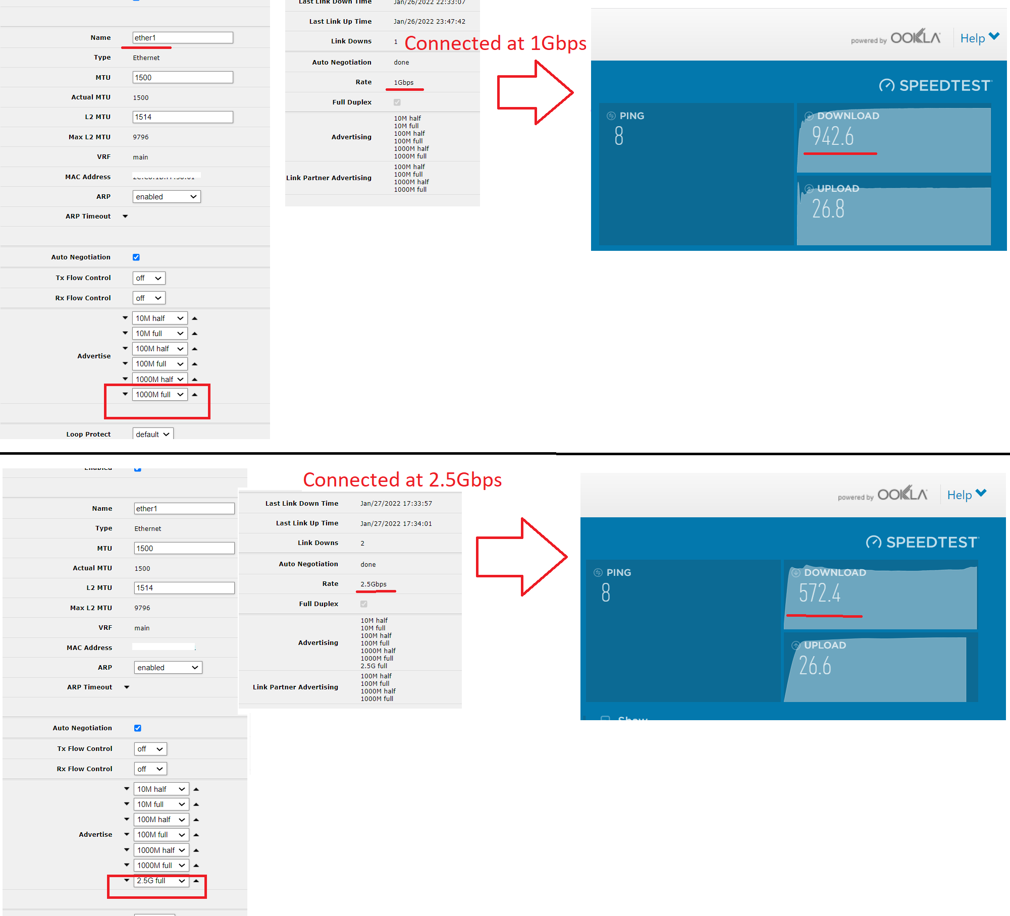

I have a 1000Mbps downlink connection to my ISP.
When connected via the 2.5G link on port 1 to the ISP cable modem, the connection speed maxes out at about 500Mbps
When removing the 2.5G negotiation speed on ethernet1 inside RouterOS and connecting to the cable modem, the speed is around 950Mbps
Steps to reproduce the issue;
Enable “2.5Gbps Full” advertise on Interface Ether1 → Internet speed test goes to ~500Mbps
Remove “2.5Gbps Full” advertise on Interface Ether1 → Internet speed test goes to ~900Mbps
Please see picture:

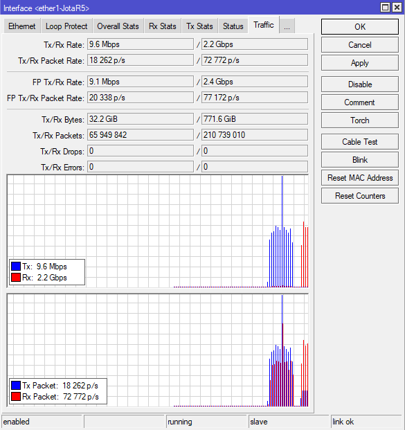

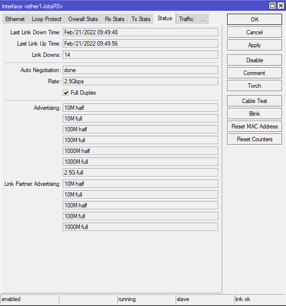

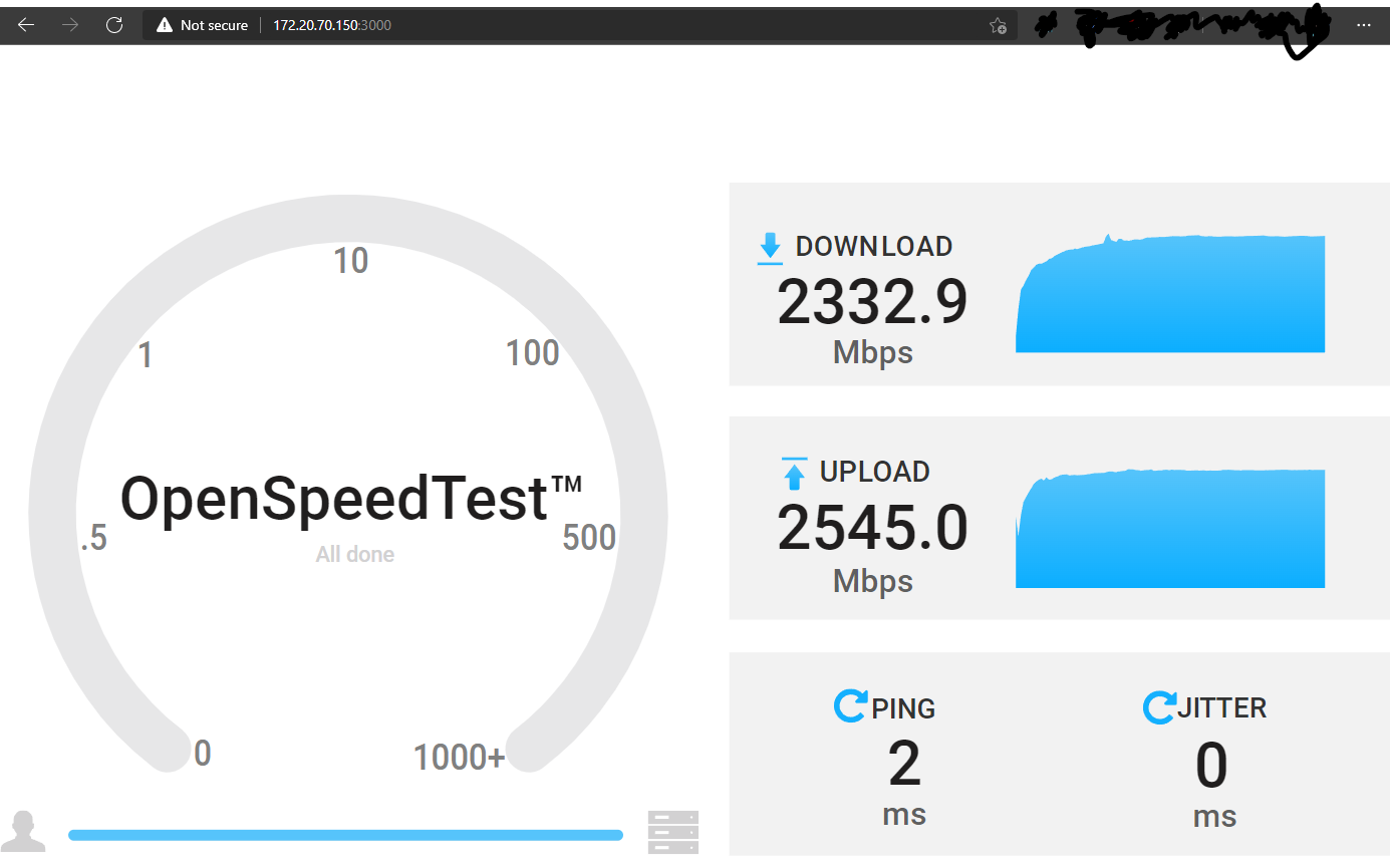

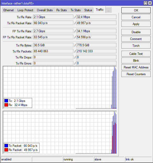

P.S: This test is a local intra-vlan to my DMZ that is in a server connected to the SFP+ port at 10G.

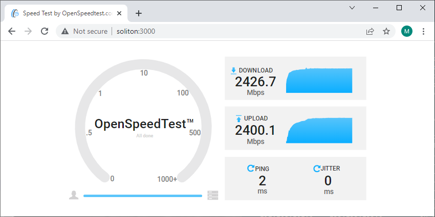

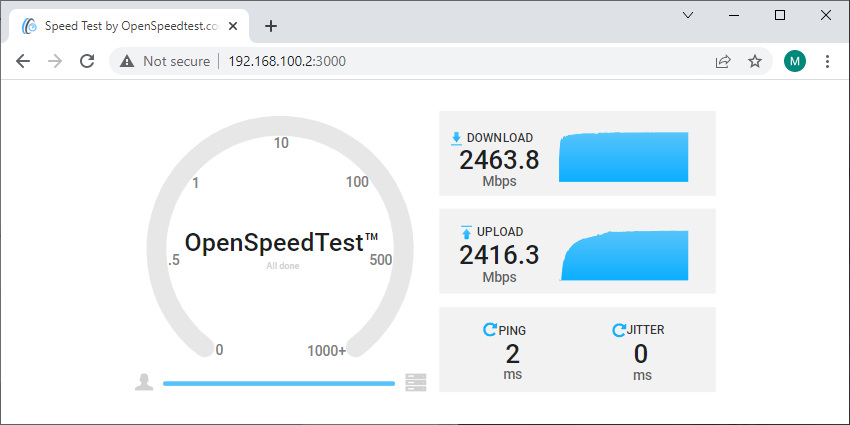

I’m getting about the same performance as jookraw using a similar setup though the 2.5G NIC I’m pointing it at is a RealTek rather than an Intel. It seems the RB5009 2.5G is ok talking to a RealTek. So far I’ve just been playing with it. I’m new to RouterOS and haven’t deployed it yet. When I do I’ll be pointing the 2.5G port at a Comcast-approved cable modem that I fortunately haven’t bought yet. After seeing this Reddit post https://www.reddit.com/r/mikrotik/comments/rq7ytu/rb5009_25gbe_slower_than_1gbe/ I think I’ll go with the Netgear CM2050V modem. It’s one of my two options for 1.2G service. The other is a Motorola MT8733 WiFi cable router. I’d have more options if I didn’t have phone service. I figured I’d wait to upgrade my modem until I got the RB5009 up and running, then after upgrading the modem upgrade my service.
The machine I have the 2.5G port on the RB5009 plugged into has a RealTek RTL8125 with firmware rtl8125b-2_0.0.2 07/13/20, running the stock driver included in RedHat 8.5. Test setup is basically:
RHEL8 “Server” RTL8125 2.5G - Cat6 - RB5009 2.5G - RB5009 SFP+ - 10G MMF - CRS326-24S+2Q+RM - 10G MMF - Solarflare sfn8522-plus “Workstation” Win10/RHEL8 dual boot
IPV4
IP V6
Normally the server machine uses a 10G Mellanox ConnectX4 and a DAC cable to the CRS, but I rearranged things to test the RB5009. The CRS is basically in dumb mode for now, though I’ll be using VLANs once I get the RB5009 deployed.
