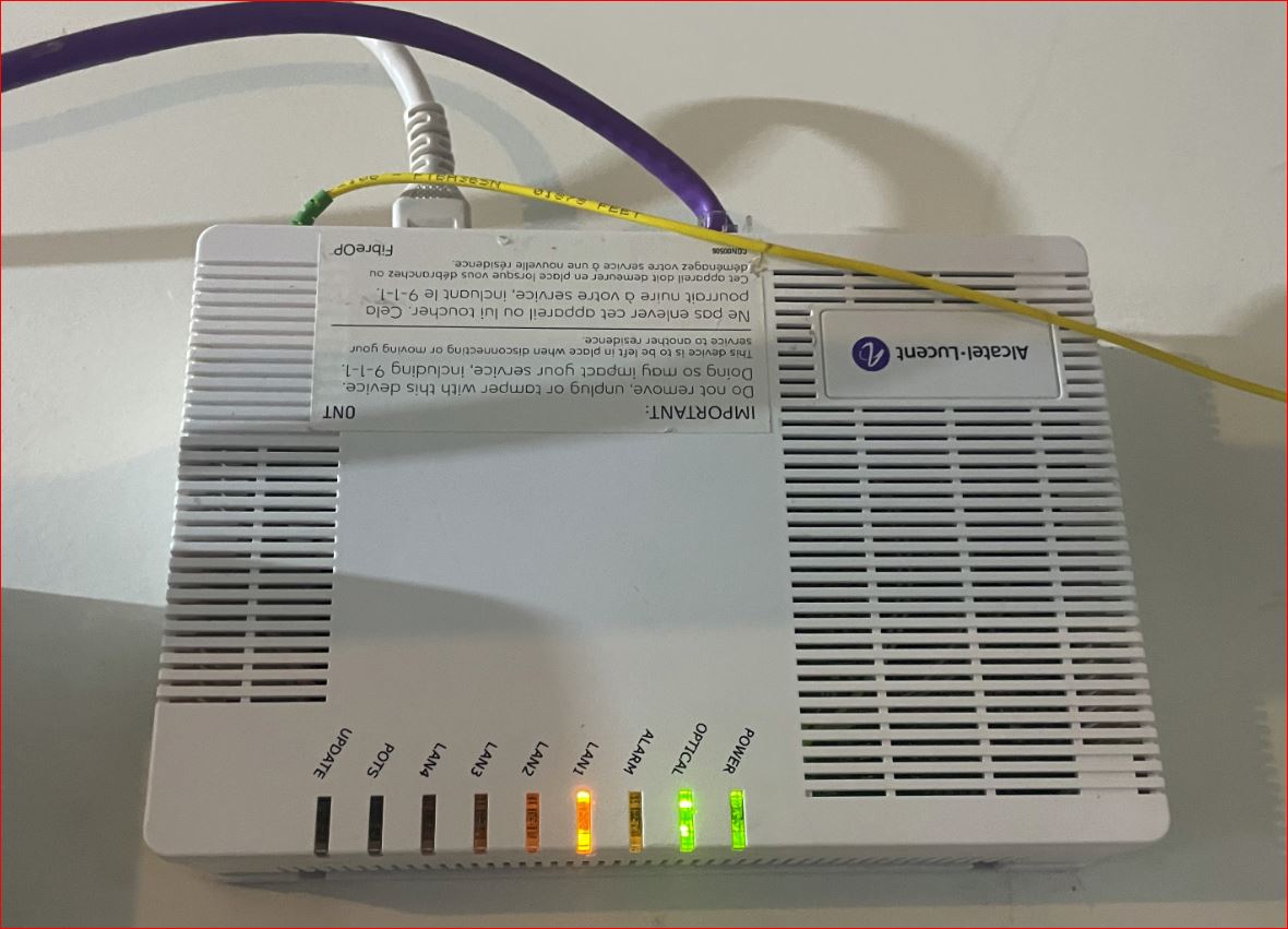

Perhaps not, interesting though. I have SFP and SFP+ on my ccr1009, may give it a whirl sometime.
My ONT is in the picture. It probably has some sort of serial number or mac address and not convinced I can replace it with a cage gpon that replaces the ONT with no mac address or serial number. Perhaps the oNT I have is just a dummy device to turn fibre into ethernet???.
How did you decide on which gpon you would buy?
