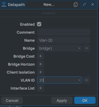

I found the Datapath in winbox now, but this is totally new to me so I have no clue how to setup that correct.
But I guess it would look something like in this screenshot and then as you say, under wifi–>configuration the correct Datapath profile is selected.
And if I do it this way, there is no need to define the PVID on the Bridge–>Inteface ?
If you do it that way, there is even no need to add the /interface/bridge/port row as it is added dynamically instead. You can think of the datapath row as of a template for that. It means you have to remove the statically added /interface/bridge/port row before re-provisioning the radios with the datapath added to the configuration.
