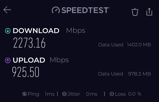

ookla speedtest app towards the server that is in the same datacenter (1ms ping)
all firewall rules enabled + fasttrack enabled
640 down
819 up
all firewall rules disabled (not fasttrack)
660 down
886 up
all firewall rules disabled + fasttrack disabled
696 down
839 up
all firewall rules enabled + fasttrack disabled
648 down
847 up

in case it helps if I do a btest I get similar numbers
tcp down ~600 at 45% cpu load
udp down ~800 at 33% cpu load
which is not using any vlans
If I go from ax3 to rb5009 using internal btest, I get 950Mbps. No VLAN there.
Cpu on RB around 50%.
And that’s a bad setup since you should never test using the devices being tested.
So RB5009 is perfectly capable of handling that traffic.
