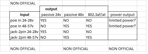

maybe is a good idea for such a versatile device to create a compatibility matrix of PoE output, something like:
NON OFFICIAL JUST AN EXAMPLE
