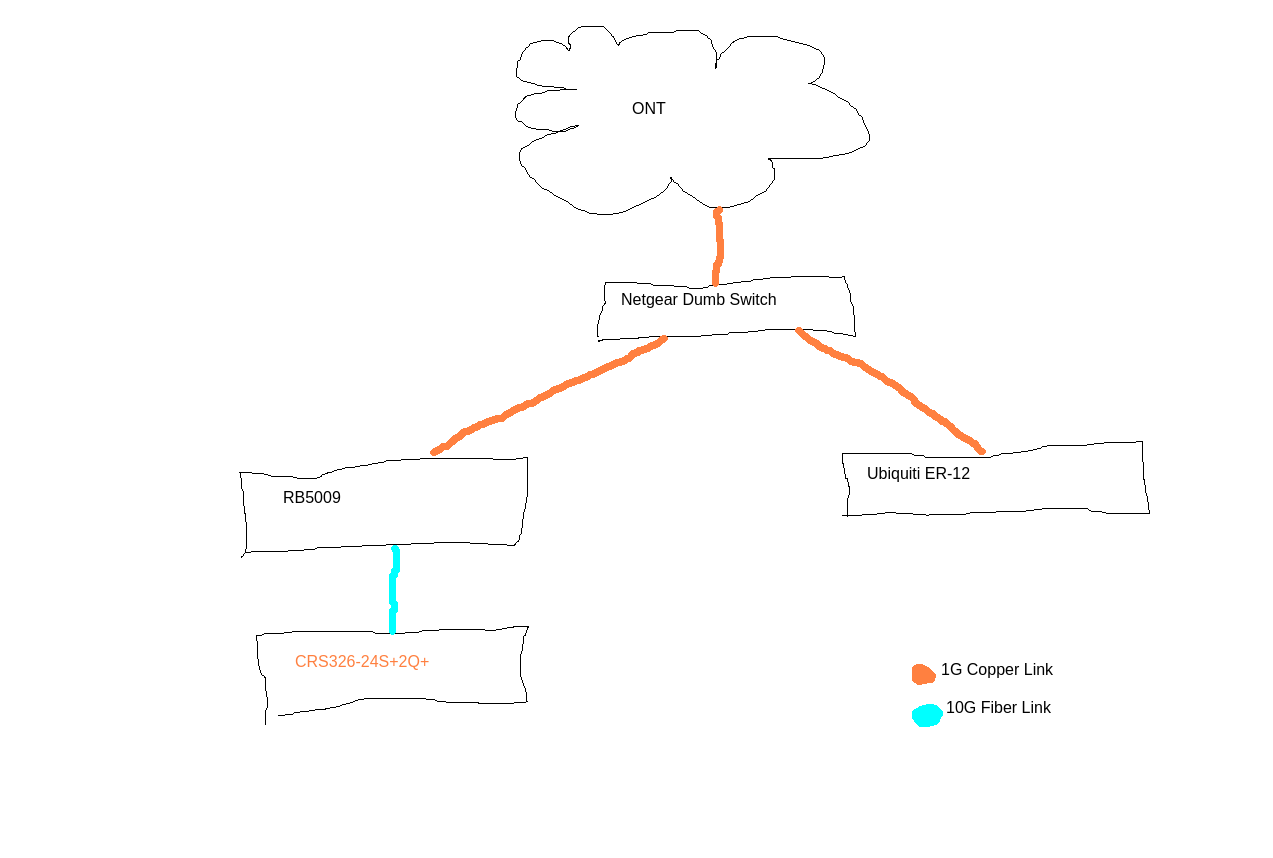

I should have clarified, and maybe RoaS is not the proper term to my setup, I’ve never been good with the lingo. ether8 goes to the ONT, which is basically serving as a media convertor as well as VLAN tagger (but that is all ISP-level stuff, not anything that affects my setup. I just pass the untagged traffic to the ONT, and the rest is PFM internet things). sfp-sfpplus1 goes to my core switch, which is a CRS326. From there, the L2VLANs are broken down based on where they need to go.
Some other things that may or may not be important:
  • You’ll see that the L2MTU on ether8 has been changed to 2000, this is to match the ONT
  • Forgot to mention this, but there is also a dumb switch between the ONT and RB5009. However, I get the same results whether the RB5009 is plugged into the ONT or the switch. Laptop testing done on both the switch and ONT get the same results as well, which is the full speed.
  • The other router on the dumb switch (see my amazingly perfect network diagram) gets the full speed with the current config, so it’s not an ONT or switch issue
