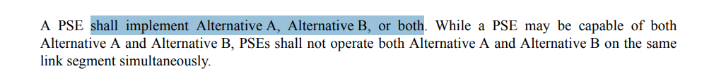

From IEEE Std 802.3at-2009
Yes, my bad :blush:, I inverted PSE and PD, hopefully corrected now.
