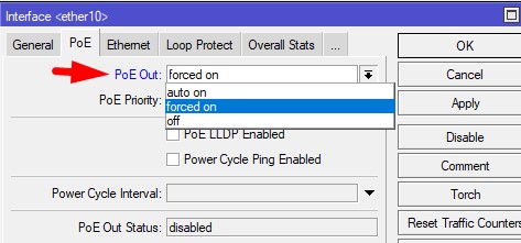

Have you tried forcing the POE on?
I have not.

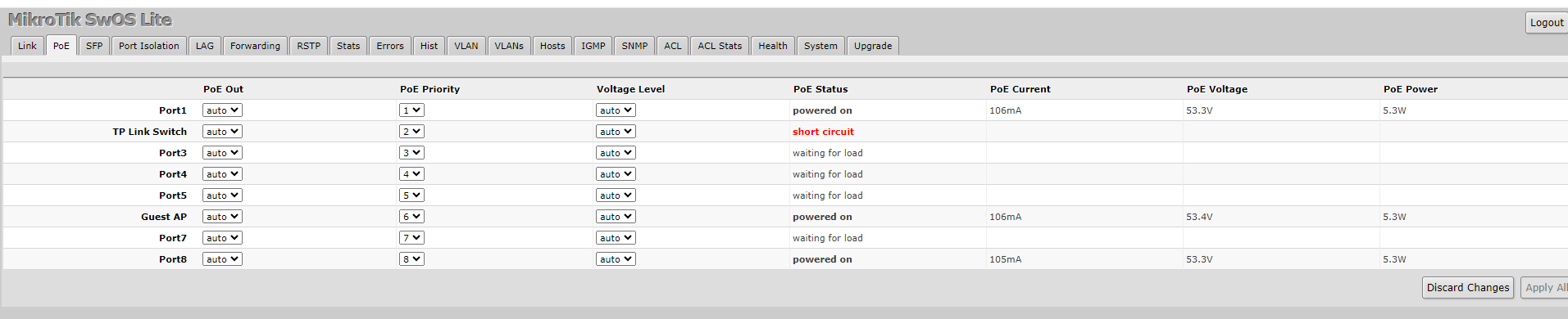

7 days and no problems driving the WAPS with the CSS610-8P.
