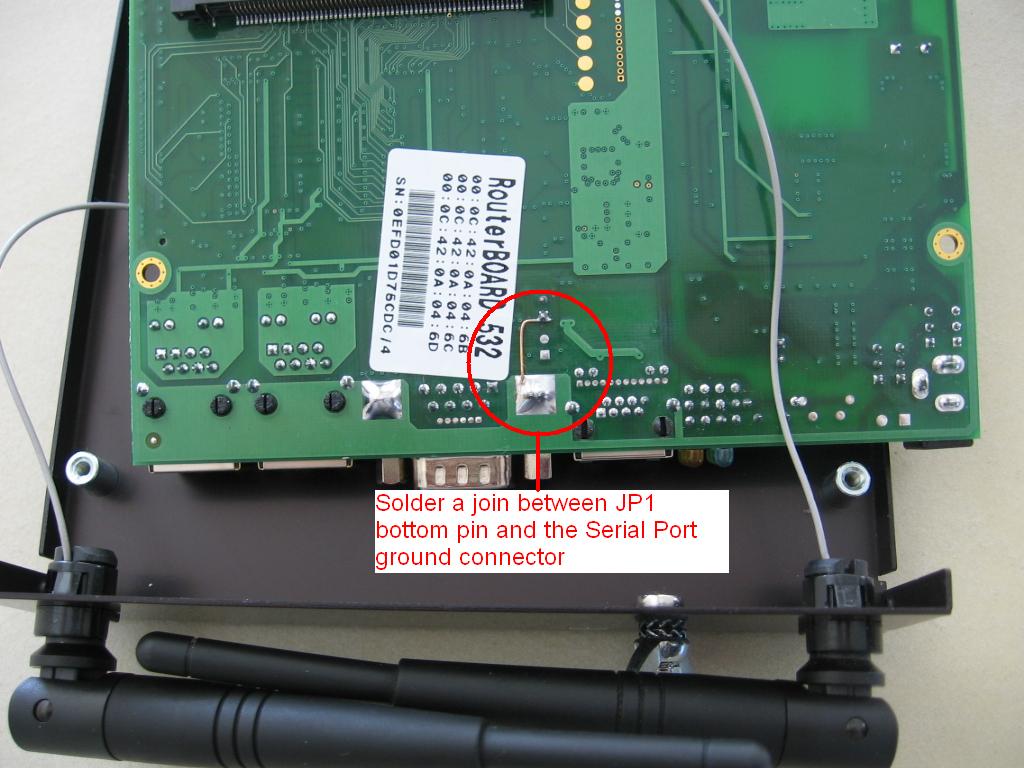

We are using RB532 radios and 14dBi sectorized antennas within close proximity of 2-way radio antennas. It has been loosely determined that the wireless setup (and more specifically, the RB532 boards) is causing interference with some of the channels on the 2-way radios.
The following recommendations have been provided as solutions:
  1. Replace RB532 48V PoE power supply with 12V power supplies - using insulated cabling.
  2. Move the wireless antennas and router boards further away from the 2-way radio antennas (approx. 5 - 8m).
  3. A third (and supposedly more effective solution) is to modify the RB532 by soldering a link between two points on the board (see attachment). Has anyone here seen anything like this before? This solution, at this point, is unsupported. Before we even consider doing this, I would like to know if this poses any threat to the functioning of the board. I assume that attempting anything like this would automatically render any warranty void?
Your feedback on the above would be appreciated.
Thanks!
the solution in the picture won’t help at all. your best bet is to put a ferrite bead on the ethernet cables, use shielded ethernet cables, and use a metal box for the RB
Thanks normis. I was considering the metal boxes, but was gently “shoed” away from that idea.
Will it not be better to use 12V DC as apposed to 48V PoE altogether?
