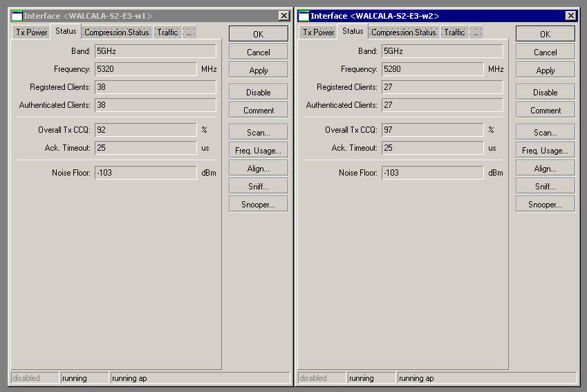

About 6 month ago, change my clients to RB112@R52, all MT and Routerboard, and I have AP with more than 35 clients with better values, ¡25 us!. See attach file.
