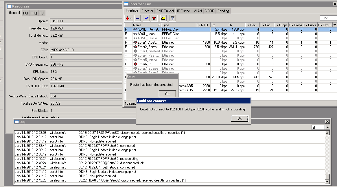

i have exactly the same problem with almost the same config.
MikroTik RB532A with daughterboard.
ive upgraded the firmware, all software packages, performed a complete reset, replace the PoE with normal power supply, disabled devices not in use etc etc etc.
No solution as yet, still struggling with issue… Anyone with similar issues?

Jan/01/2002 03:00:03 router was rebooted without proper shutdown by watchdog timer.
I had an open session just before it happened- There was 8Mbps traffic between two Ethernet interfaces.
