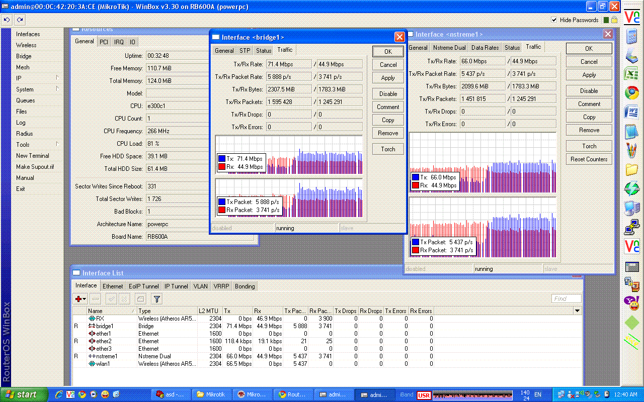

I have RB600 on Dual Polarty Anntena V/H 32db Parabolic LMR400 Cable, im use it for point to point 2Km configuration
BOX1 DUALNSTREMME
WLAN1 - TX Turbo 5800Mhz
WLAN2 -RX Turbo 5200Mhz
48V 1.5A POE 10 Meter SFTP cable Giga Bit switch link read 100
BOX2 DUALNSTREMME
WLAN1 - TX Turbo 5200Mhz
WLAN2 -RX Turbo 5800Mhz
48V 1.5A POE 60 Meter SFTP cable Giga Bit switch link read 100

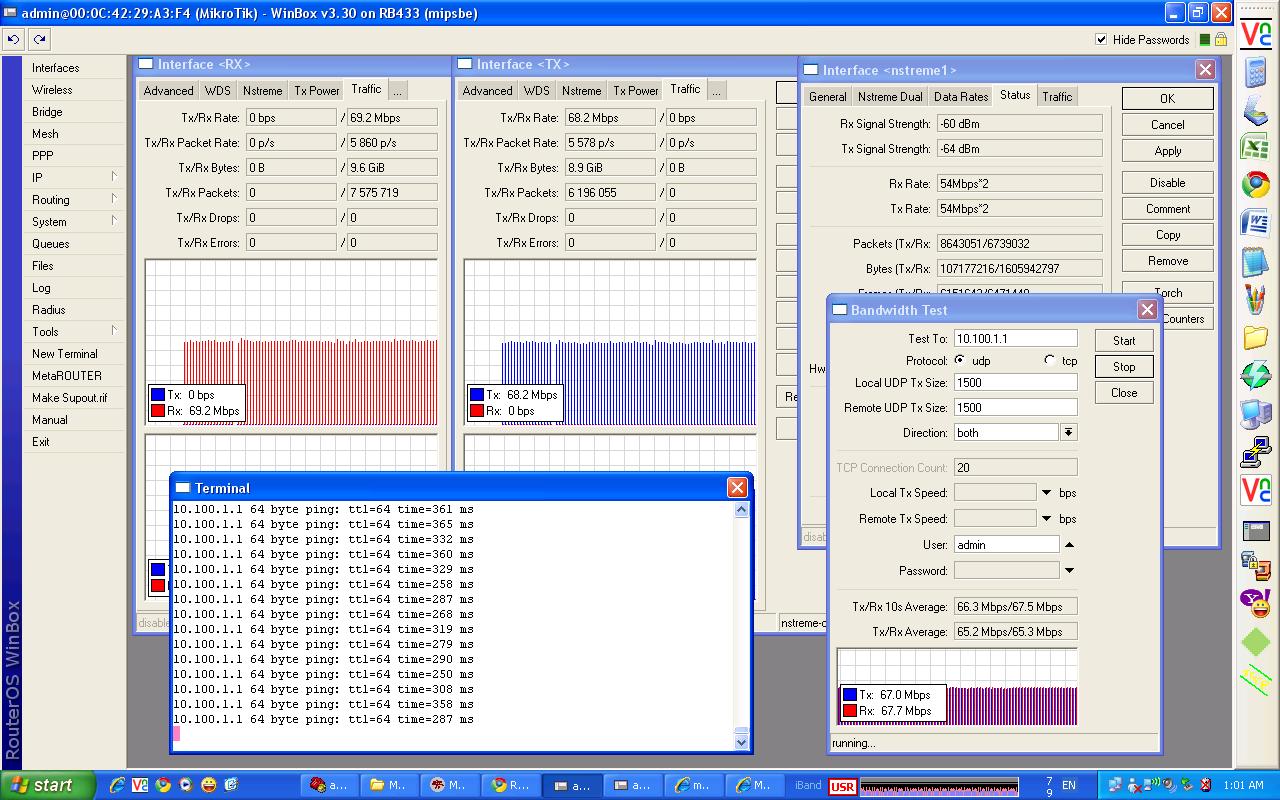

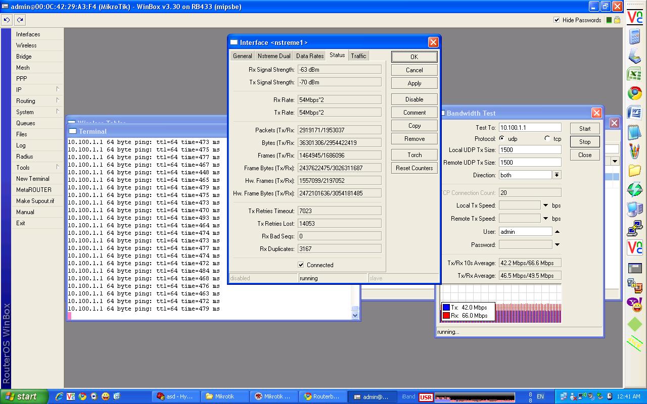

and attached the testing use with BOX1
RB433 with
WLAN1 TX XR5
WLAN2 RX RB52 65mw
24V1A POE cable 1 meter
