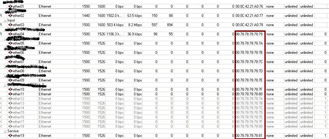

With the RB816 we’ve got some problems, the mac addresses on each LAN is the same. Do you have any idea how to fix this?
I’ve changed the port for winbox and it’s working fine, now I’ve problem only with the mac addresses that there are the same MAC addresses on the RB816 how can I change them?
Thanks for your help in advanced
  1. Change MAC-addresses manually via console, /interface ethernet set etherx mac-address=xx:xx:xx:xx:xx:xx
  2. Run /system reset-configuration to get correct MAC-addresses.
