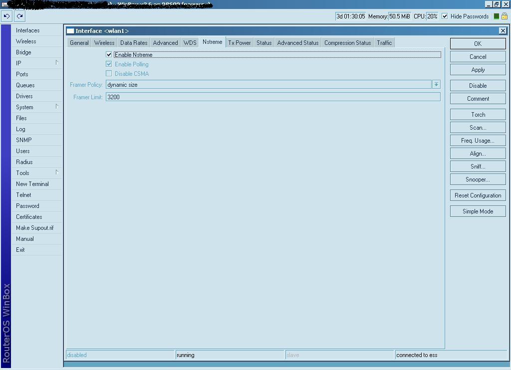

I succesfully upgraded the firmware to v 2.13 and the random reboots totally disapear.
But now I have two minor issues. In winbox appears to be disabled enable polling and disable CSMA also framer policy and framer limit too, this is only on winbox, in the console everything is ok. The other issue is that the ether1 reports inconsistents traffic values.
iterlink,
this is specially made so, because you don’t need to change those values if the wireless interface is in the station mode. Those seetings are only needed for the AP interface as the AP interface will tell it’s clients what nstreme settings to use.
So, that is what I was saying before…OK.
