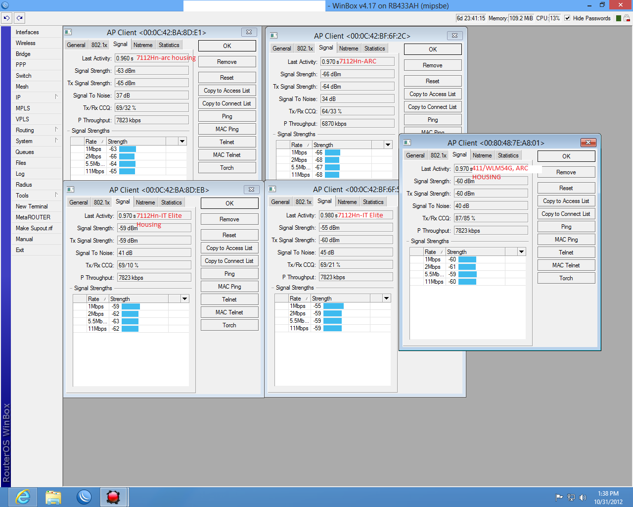

RB711-2Hn Transmit Issues
Curious if anyone else has seen low tx signals or ccq’s when using this integrated combination. Tried in both IT Elite and Arc housing, but tx is offset to rx signal by up to 15db. Also tx ccq’s are around 10% as opposed to 100% compared to RB411 w/ r52h radio card combination. Any feedback would be greatly appreciated.
