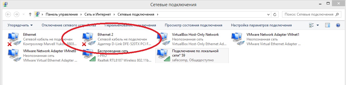

Was connected switch, but he remained alive. Netinstall does not see an access point since with it in General there is no physical communication - Windows writes: “the network cable is not connected”. The cable is whole, the connector is whole, the power supply is whole.

I’m doing it this way. Perhaps you misunderstood me. The computer does not physically understand that there is a device at the other end of the cable. Are you sure that with this connection netinstall will see the access point?
