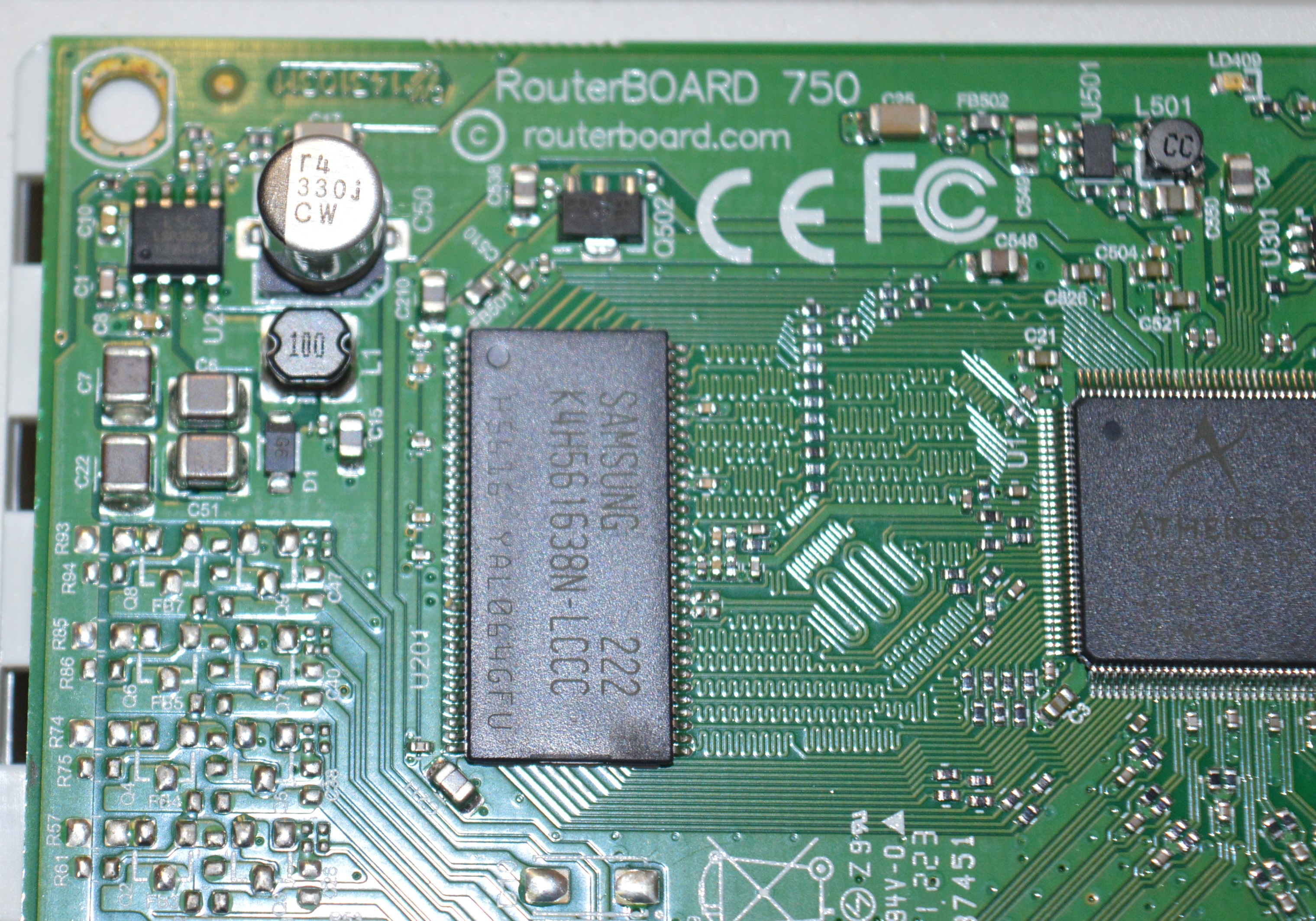

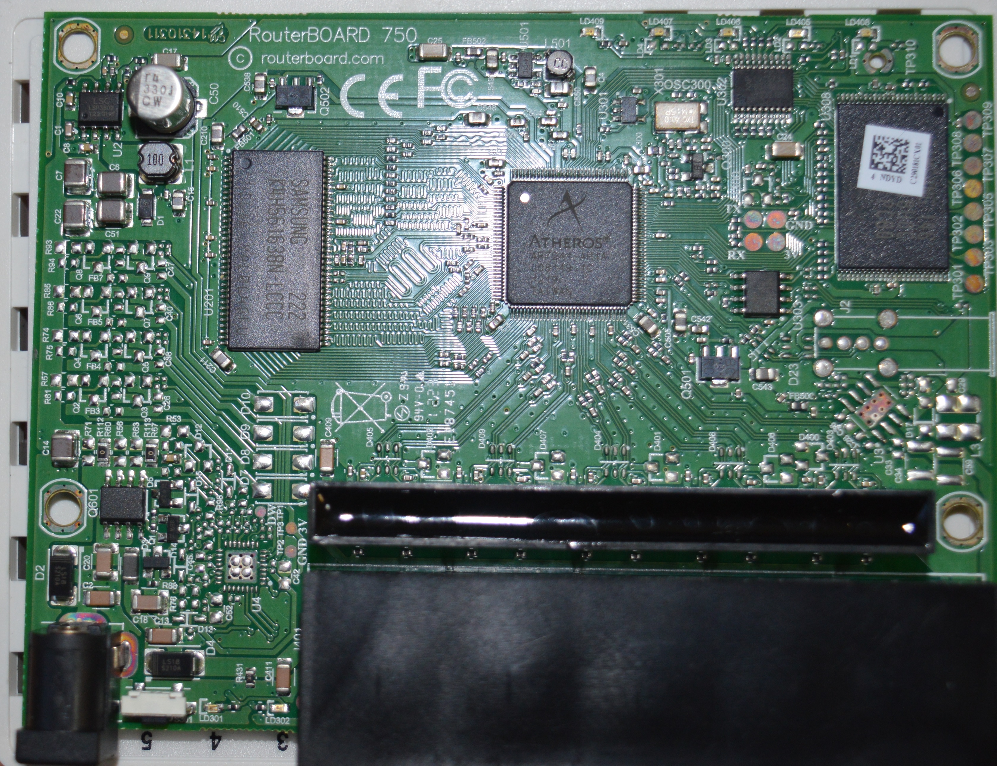

There is a model rb750 defective RB750 Aluminum Electrolytic Capacitor SMD need replacement located C50 labeled r4 330j cw the search in the network does not find the model and characteristics.
Please help to find out the capacity, voltage, manufacturer, model to replace?
Write an e-mail to support@mikrotik.com and hope they can give you specific info.
If there is j not capital J after 330, then it is 330uF 6.3V 105*C
Tech support answer is:
C50 is a Capacitor PolymerAl 330uF ±20% 6.3V 3.16A 17mOhm 2000h 6.3x5.7 SMD. P/N: MP6VL330MC5R7
