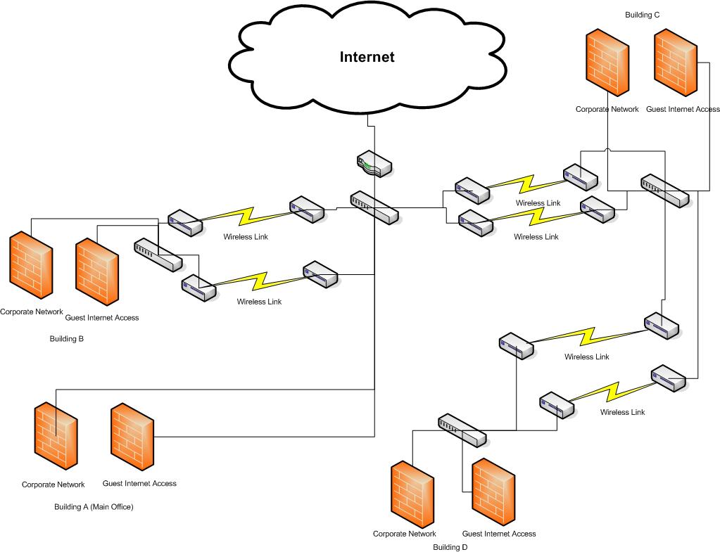

I’d like to use an rb750 at a satellite office to provide load-balance/failover for two wireless links back to the main office. I’d also like to use VLANs so I can hang two firewalls off the router, one for the corporate network and another for guest access. The main office will have the rb493 that’ll connect to our fiber connection. I’d like to do this for 3 satellite offices. If I can do some bandwidth throttling on the rb493 for the guest access that would be good so the wireless link isn’t saturated. If not, I’ll see what I can do on the guest firewall. Does this sound feasible? Thanks.

I want an rb750 at each site and an rb493 at the central office so I can have a sort of hub/spoke config with the central office being the main site (and the internet connection). It’s slightly more complex due to one of the satellite offices not having line of sight to the main office. I’d like to use the routerboards strictly for connecting/routing traffic of the sites, I’ve got existing corporate and guest firewalls at each satellite. I want to use the single internet connection at the central office for all the satellites (both corporate and guest). I really only suggested the rb493 so I have enough physical ports on the router. I’ve attached a network diagram to try and make things clear.
That would be possible.
But I would recommend using a RB433 mounted in a Poynting A0042 case (or similar).
Then connect them to a switch or RB750 or RB450 and then to a switch.
Both have advantages and disadvantages:
Connect them directly to the switch: You can use VRRP for failover
Connect them to a RB first: You can use two different routes for TX/RX giving you a somewhat full-duplex WLAN.
