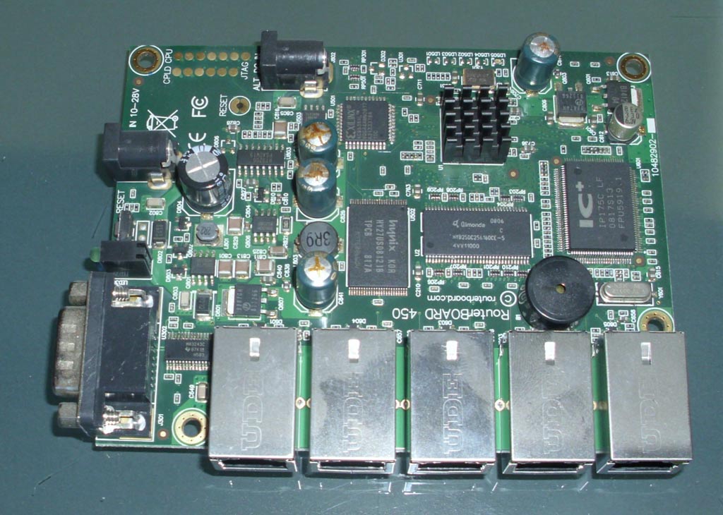

… I know that this thread is almost a year old, but I came across another broken routerboard.
This is the same problem that I saw in a few 750’s (that this thread is about) … this is a 450.
I looked into one of the newer 751’s and there seems to be only solid-state capacitors inside. So hopefully the newer models will have a longer expected lifespan than the old ones with electrolyte capacitors.
