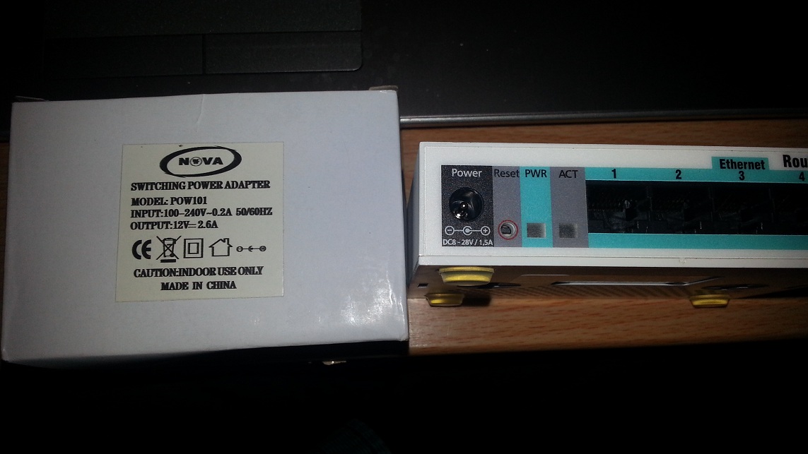

Hi Everyone
One of my suppliers recently stopped supplying the Mikrotik RB750s with the usual power adapter which come inside the box.
Instead they supply us with their own power adapters which are 12V / 2.4A .
I am now worried that they may blow the units or cause hanging up (as I have read in other forum topics)
I know the volt rage for the RB750 is 8-28V, but what is the amp range?
I get the feeling my supplier is trying to cut costs by supplying cheaper PSUs
Your device will only draw as much current (amps) as it needs. So hooking up a router that draws 1A to a 2.6A power supply won’t hurt anything as long as the voltage is in spec and the polarity of the connector is correct, and it is according to the box.
