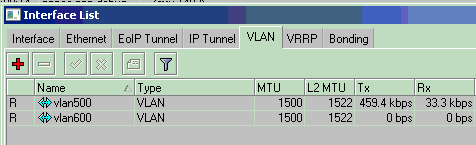

hi guys i’m having problem with my vlan setup… for my rb750 & rb250gs
my network is as below…
my rb750 has default ip of 192.168.88.x
my interfaces & vlan as below..
my pppoe dailer is attached to vlan500 which is attached to the gateway port of the rb750
vlan600 is also attached to the gateway port of the rb750 which carries the iptv signal
the problem now is, i know i can use bridge and link my vlan 600(iptv) to an unslaved port of the rb750 but that will carry my iptv traffic only..

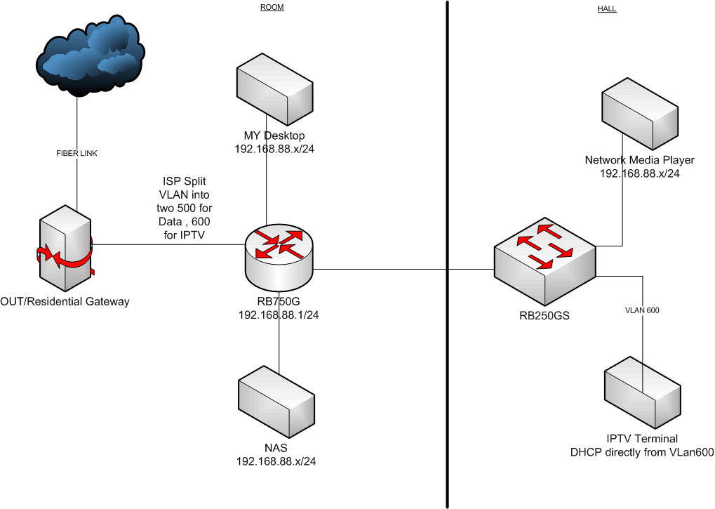

but now i want to trunk vlan600 and default vlan , to the rb250 that is located at my hall, with my tv and so that
the iptv receiver and my network media player.. can both work together
how do i do the config on the rb250 and is there any other additional configuration needed on my 750 so that i can make it work ?

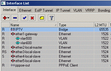

hi all…well i got it to work..
on my RB250 side , 1 port for trunk to link to the rb750 , 3 ports for lan over vlan1, while 1 port for iptv over isp’s vlan600
here is the configuration im using for my rb750, that seems to work, but i’m not sure if its the proper way to configure it..
