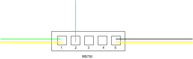

hi guys
just want to know
i have a trunk with vlan100(green) and vlan200(yellow) coming into my rb750 ether 1
while my default network is on the default setting which i assume is vlan1
i have another trunk out of ether 5 that should trunk out vlan1(black) and vlan200(yellow)
while my vlan100(green) is bridge to a ether2
how do i trunk my ether1 vlan200(yellow) so that it goes out ether 5 unmodified ?
what i have done is..
for vlan100 green, i created a vlan100 and attached it to ether 1 and bridge it to ether2 so it comes out untag
but for vlan200 how do i, do the configuration ?
nvm i found a way that works.. but not sure if its the most efficient way…
create vlan200(yellow) on ether1 and 5
create a bridge and bridge them both, the vlan not the ether interface
while vlan1(black) create a bridge and bridge it to a ether2/masterport
