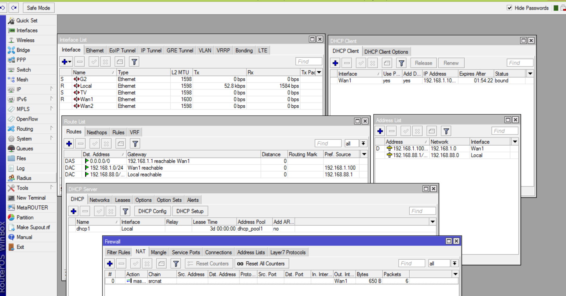

From my dsl connected to pc port
cant ping 8.8.8.8 my cable connected to RB750 but can ping directly connected to pc port
Did i miss something to post?
O, it’s a joke. But with only one picture how you think to solve problem?

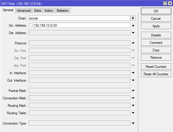

From the picture, the settings look correct…
That being said, I’ve had better luck adding the local subnet to the NAT rule and not using the out interface setting.
Also, make sure that you have the network settings (network, subnet, gateway, dns) entered in the DHCP server → Networks tab. I caught an IP typo I made in DHCP Networks before that stopped NAT/internet access.
Thanks working now
