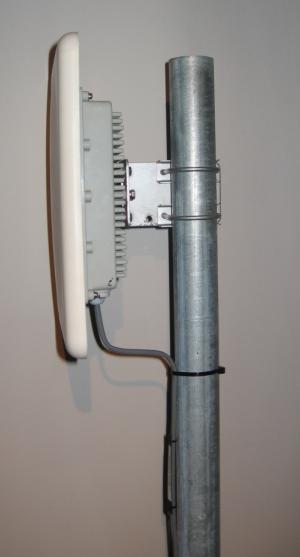

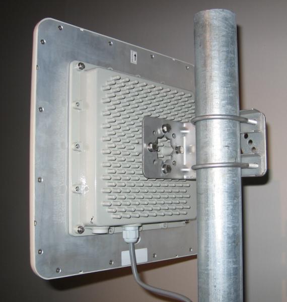

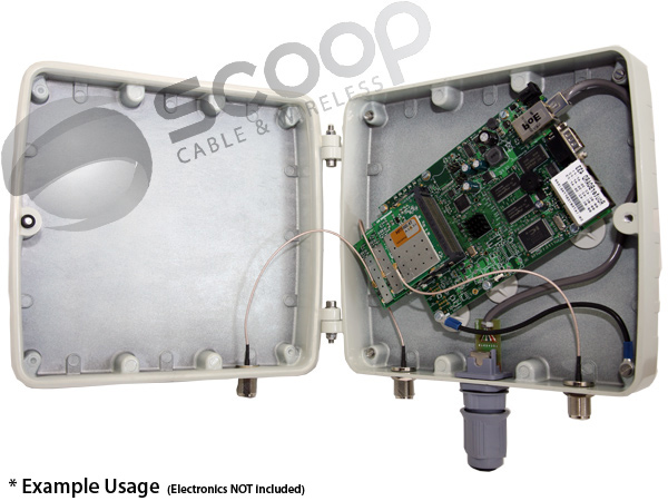

For outdoor applications we have standardized on 2 enclosure types. For integrated units we use a diecast aluminium unit with integrated 23dB flat panel, and for external antenna we have a diecast aluminium box with external connectors (see attached images). We can fortunately purchase these quite cheaply locally (under US$35 for the enclosure and about US$100 for the integrated unit) and I feel these installs look quite professional.
