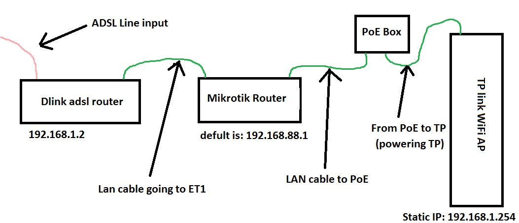

I am currently running a Dlink ADSL router connected to a TP-link outdoor WiFi AP.
I have about 25 different users connected to the AP via MAC address filtering, and so far so good. :smiley:
Why I Bought a RB750:
I bought a RB750 with the primary goal of setting it up between my Dlink ADSL router and the TP-link AP.

Edit: Ive added an illustrative picture
I would try to put the dlink router in passthrough mode. That means you only use the ADSL modem of it and it isnt’t doing any routing at all. Once you have done that you can/need to configure the pppoe connection on the RB750.
If your TP-Link AP is really an AP and not a router everything is fine with the setup. You can configure mac filter at the AP but that’s not really a security feature. MACs can be changed. As you want to encrypt the wifi traffic anyway you should configure WPA2. If you have done that the access is already limited to the ppl who know the WPA2 password.
QoS can help but if someone fills the DSL line with his p2p traffic it might not help enough. So blocking p2p is not a bad idea. But there is always a way around. It’s impossible to detected all p2p traffic especially if encryption is used by the p2p client. As it’s also difficult to hide all p2p traffic i would tell the users that it’s prohibited and you disconnect them if you detect them violating the rule.
