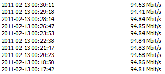

I tested my RB750G, and here is the results from my 100 Mbps line (bandwidth test was measured ten times in a row).
Minimum: 94.4 Mbit/s
Medium: 94.8 Mbit/s
Maximum: 94.9 Mbit/s
