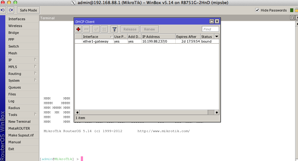

It shows it as /32 here. Where does it show /0?
screenshot attached.
