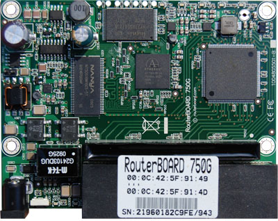

RB750G revealed!
What’s inside the brand new RB750G.
For a larger top and bottom image…
http://www.roc-noc.com/rb750g_top_naked_large.jpg
http://www.roc-noc.com/rb750g_bottom_naked_large.jpg

the PCB is the same cpu and switch chip than the RB450G, so why is it so lower (performance) than RB450G?
it uses AR7161 (680Mhz) and switch chip AR8613 (gigabit)
I think it’s 680 and Gb ethernet but with 32Mb : P!
Veo que eres de España, bueno la verdad comparando con el hardware del RB450G es la memoria y el puerto serial lo que varia mas la licencia, pero segun las especificaciones tecnicas que da mikrotik da un performance de hasta 580Mbps con paquetes grandes (1500) y con paquetes chicos 91500 pps que es aproximadamente 60 Mbps.

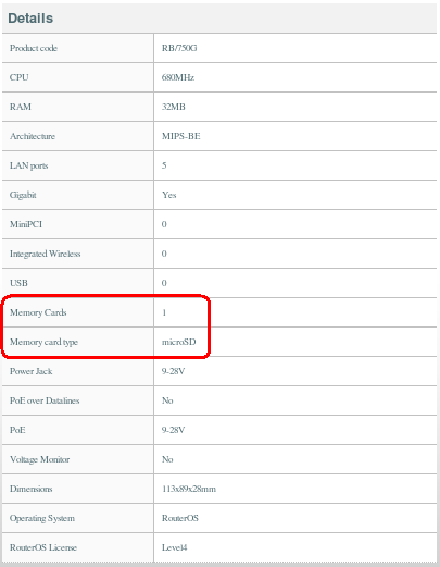

Where is the microSD card slot on this thing? :confused:
it doesnt have this unit, just the RB450G and 433AH and 433UAH
How do you know that, do you have one? The product specification says it has one microSD card slot.
http://www.routerboard.com/pricelist.php?showProduct=90
Yes I have one a few feet away from me as my home cable network router and they do not have a microSD slot.
Look at the pictures. It is pretty obvious by the pictures posted that there is no place for a microSD card. (There are links to front and back PCB shots.)
Read the RB750G data sheet. It does not mention microSD. The only mention is on the routerboard.com site and I believe that Normis forgot to delete that from the RB450G information that he probably copied. Or perhaps Mikrotik is selling a different version from routerboard.com than they sold to their distributors (not likely).

It doesn’t have microSD card slot.

And one more thing, my RB750G doesn’t have any beeper as written in the brochure/data sheet.
Brochure says: “Extras : Reset switch, Beeper”
datasheets fixed, sorry for that :frowning:
