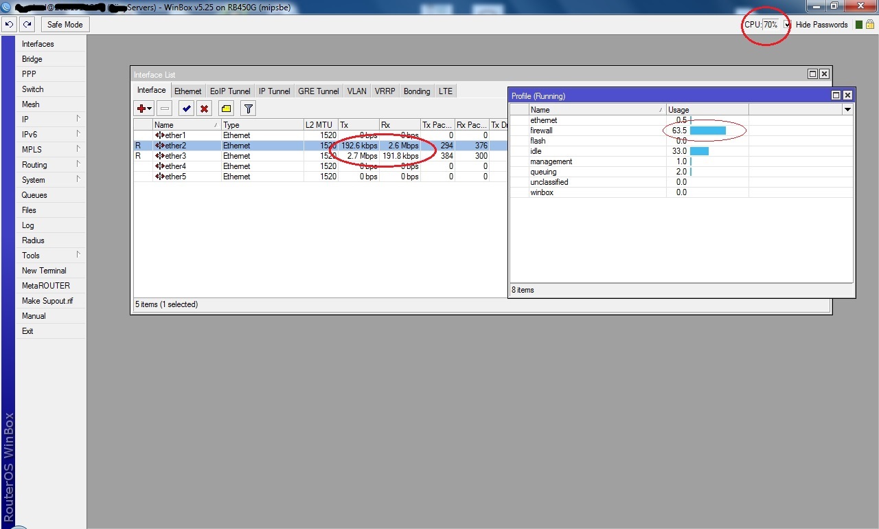

Brother Saleh,
Check attach image of RB450G, bellow 3MB bandwidth load but CPU usages 70%, Giga bit transmission is possible but in real life corporate scenario firewall, queue list and routing all are in same router so CPU goes high!!! It’s purely depends on how you use/configure it.
Yes, It’s depends on how you configure.
