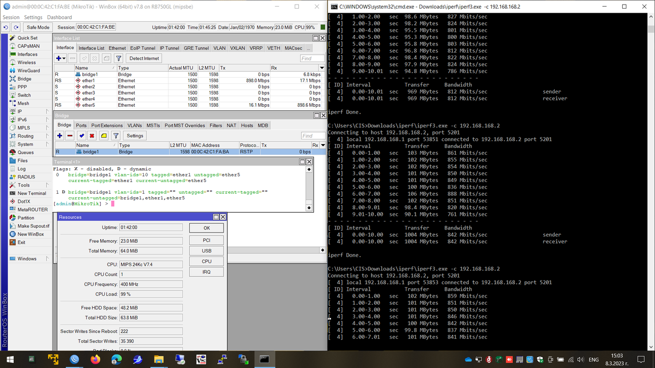

Bridge vlan filtering performance results :
That throughout actually looks better than I expected.
I’ll fix the configuration when I get a chance and monitor the CPU usage when the system is in use.
Thanks everyone, I’ll let you know how I go
Thanks for posting real results.
If you still have the config loaded, can you do an iperf test with 60 byte packets (82 or 78 bytes ethernet frame depending on whether vlan tag is present or not) through the RB750GL and also through a dumb switch. That should show a bigger difference than with 1500 MTU packets, because the majority of the CPU time is per packet (it is setting up a transfer and then the ethernet controller probabaly uses DMA when actually sending the ethernet frame). So you are more likely to notice the limits pushing small packets through (for example 20 bytes of tcpdata will result in 60 byte + 22 bytes of ethernet overhead (with vlan header). using --set-mss=20 if memory serves.
But this is primarily for curiosity sake. The application that @happydaisy posed isn’t going to be data intensive. And if the DHCP server is on the RB750GL, then the packets will always hit the CPU anyway, so doing stuff in the switch ASIC isn’t going to make a measurable performance difference, so using the “standard vlan-filtering bridge method” is what I would do given the circumstances.
I have a couple of RB951Gs, which feature a bit faster CPU but same switch chip. And I can tell that when configured via switch chip menus (including VLANs), this thing can do wirespeed without CPU even noticing. If done via bridge menus, it’ll be able to go to 1Gbps between a pair of ports, but with CPU pegged at 100%. I never tried running tests between two pairs of ports concurrently (because I don’t have enough capable wired devices at home), but I guess it would divide CPU throughput between the ports. And as I already wrote, the config on switch chip is not something worth a PhD (even ChatGPT might get it working).
