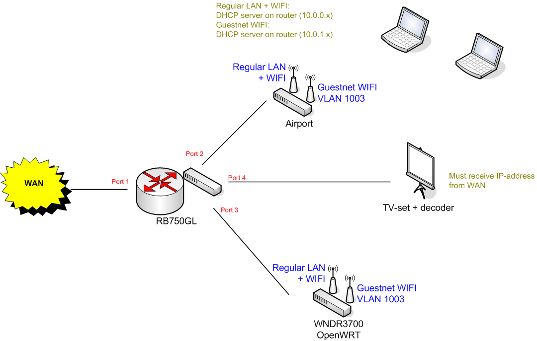

See atachment for the layout of my network.
The essentials are:
Port 1 is the connection to the Cable modem
Port 2 go’s to my airport time capsule
port 3 go’s to my WNDR3700 (openwrt)
For my normal network, everything is working.
But I will also use the Airport guest network to work properly. I know the airport uses a VLAN 1003 for this guest network.
Previously, my WNDR3700 (with openwrt) was my main router, and on that router i was able to make the guest network on the airport work (with a Vlan id 1003)
Now with my RB750GL, I tried to create the same thing, but is doesn’ t work, users on my guest network are not able to receive an IP-address from the DHCP server.

(the link to my TV set, have I not yet tested, First the aiport guest network must work, so the config is only for the first part of my needs)
I’ve read one of the other topics, but it didn’t work out for me:
http://forum.mikrotik.com/t/vlan-setup-for-wifi-ap-guest-ssid-separation-step-by-step/84428/1
I’ve solved it by creating a bridge between the 3 ports in stead of putting them in a switch (port 3 and 4 are separated masters en not slave of port 2)
At the bridge level, i’ve created the VLAN
But is this the best solutution, why doesn’t it work when i create a Switch in stead of a bridge?
