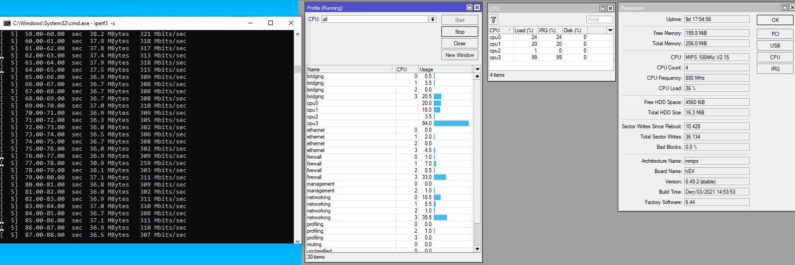

VLAN in the RB750Gr3 is about 310-350Mbit, and CPU load about 99% at one core (RB750Gr3).
Test is done in minimal setup, no fw roules. Test is with cat6 cable, directly from MT to two computers.
When testing on same bridge without VLAN, speed is about 750Mbit, and CPU load is low.
For now i don’t want ROS 7.x
Update: When doing more streams 3-8 are tested at VLAN, speed is about 700-750Mb between segments, so for me ok :slight_smile: . And then it spread it over more CPU.
